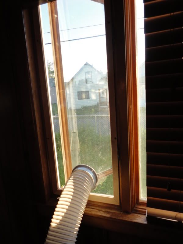

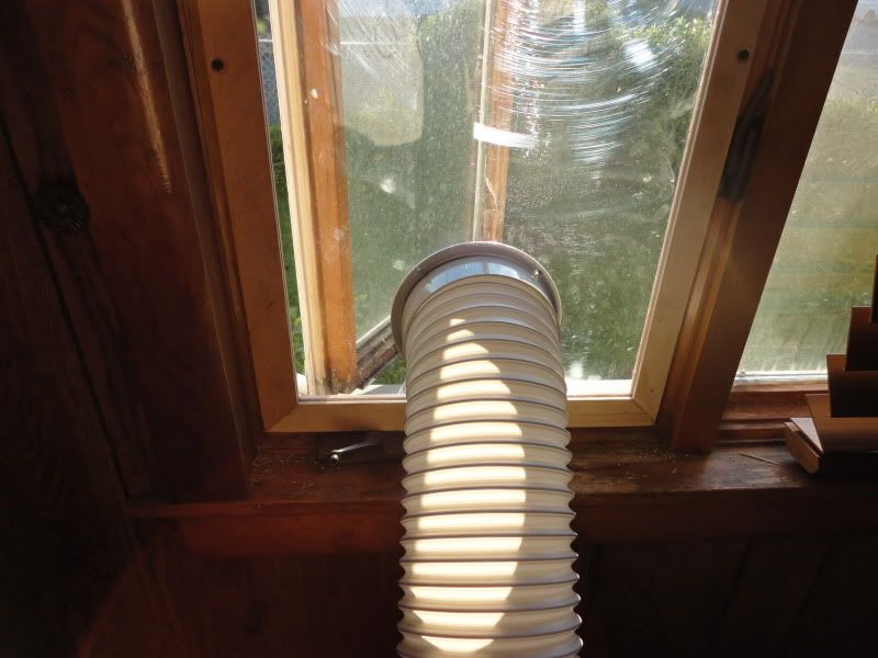

Just thought I would share what I did and hopefully it can help other people. I searched for a long time for a portable AC unit since I have casement windows. It seemed everything had such mixed reviews. I ended up pick up this unit http://www.air-n-water.com/product/ac-14100e.htm took about 2 weeks to come in.
I then picked up some pine to make up a frame and grabbed some lexan from work. I used a 3/8" straight bit and cut a pocket in the pine and then made up a frame for the lexan the same size as the screen that goes into the window. Next was drilling a 6" hole for the vent tube and connecting it.
Ive had this AC unit for a few days and Im very happy with it, cools the house quickly which I was surprised.
good idea with the plexi glass.

Yeah, that’s almost exactly what I did with mine except I added a cross piece in the middle to make it look more … windowey.

just another thought…my dad uses a portable one with the duct to the window just as pictured above…and he noticed that the duct itself was very warm from the exhaust…so he bought some duct insulation sleeve and insulated the hose…it’s less pretty, but lets be honest…that corrugated hose isn’t necessarily pretty to begin with…and he said it made a HUGE difference in how well the unit cooled his bedroom…
