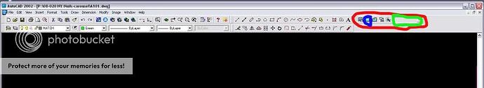

ok, in your toolbar space, right click on a blank gray spot and a menu should pop up. cursor over “ACAD>” there will be little checkmarks for what toolbars your using. there should be one labled “veiwport”
click that, and then you will have a box that looks like this circled in red:
you can click the button circled in blue, then the box in green is where you select your scale. You click and drag the shape of the veiwport and your good to go
edit, that pic sucks, if you cant see clearly enough what it looks like let me know ill try to get a better screenshot

Yes, I can now get the charts to take up most of the page, but it looks crappy as stated above
Also, LT2007 only has 2 buttons and the scale dropdown.
focusinprogress:
