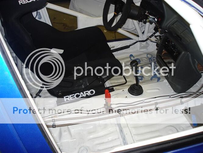

Here are a couple of pics of the interior and brake bias adjusters:
And, finally, the driver’s floorboard:
