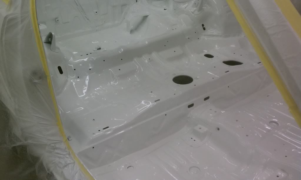

For some reason I thought it was yellow OEM paint or something lol.

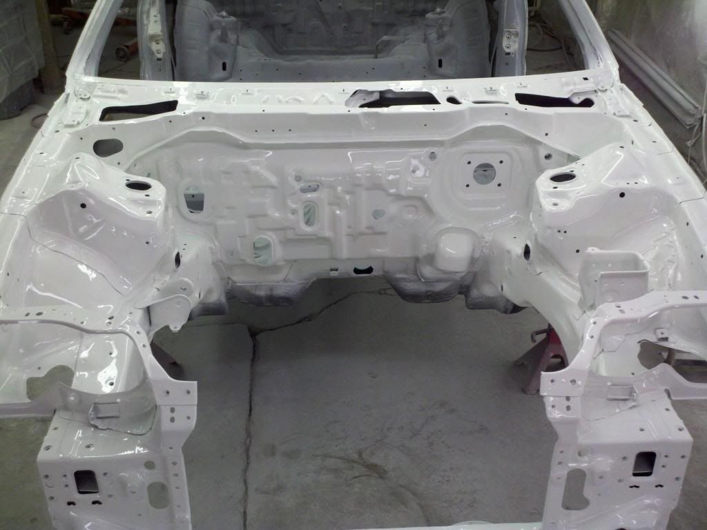

lol no we just taped it off. Everything was primed, sealed with a white sealer, base coats and alot of clear so we have enough material to work with when wet sanding.

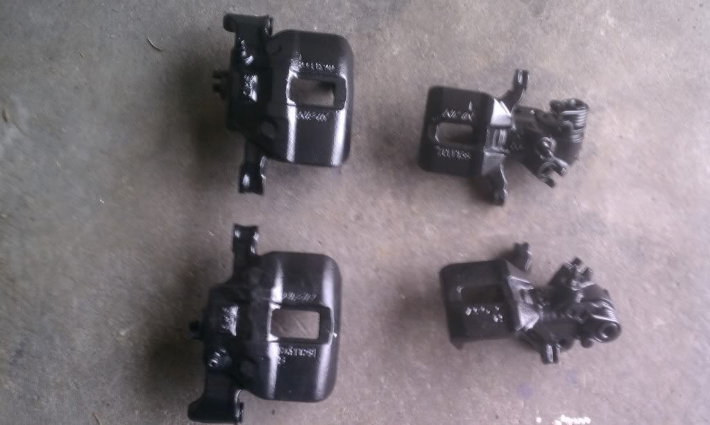

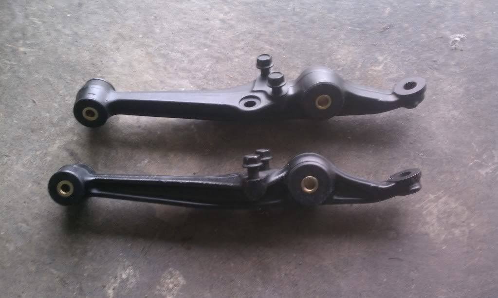

Repainted my calipers and got all of the engery suspension bushings in the front lcs’s

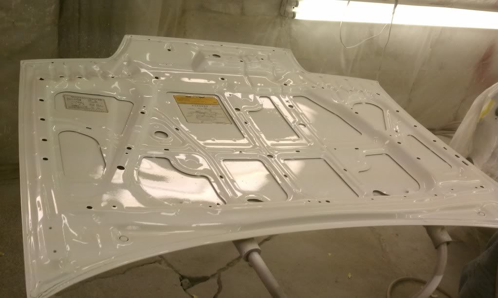

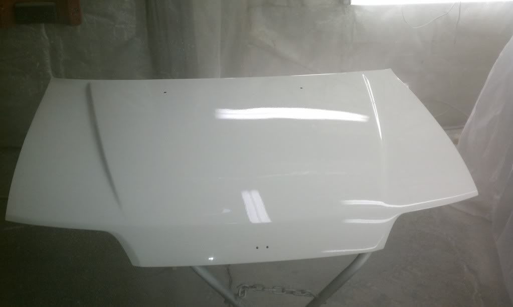

The outside of the car was sprayed as well as the hood and the front bumper. The inside of the car will be done tomorrow and I am bringing her home saturday morning.
---------- Post added at 02:21 AM ---------- Previous post was at 02:19 AM ----------
The black will be sprayed on the front and rear bumpers with a trim paint after we wetsand the car. We are waiting to wetsand and buff the car until after I’m mostly done with the assembly just in case I put a little scratch or something in the paint.

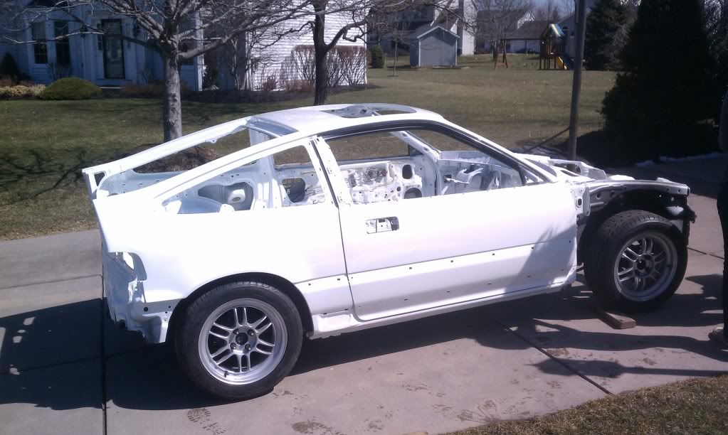

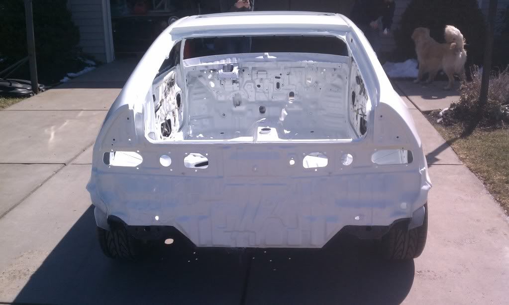

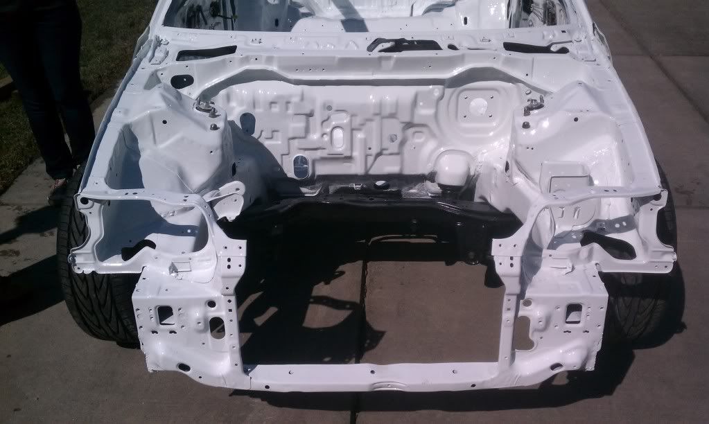

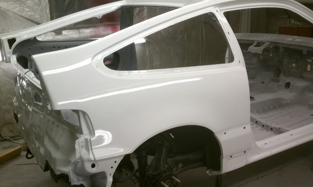

He finished the inside of the car, underside of the hood, radiator support “t” bracket, and hinges today. I’m bringing the car home around 11 in the morning so ill have pictures of it out in the sun. Here are a few for now.
More to come soon

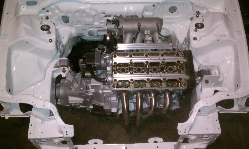

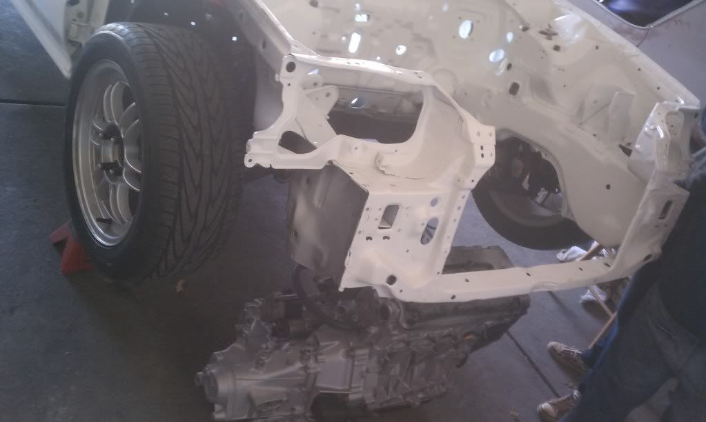

Put the motor in today. After putting it through the top last time and scratching my frame rails because there is less than an eight inch clearance on each side I picked the car up high enough to slide the motor under the car and lifted it up through the bottom.
---------- Post added at 10:56 PM ---------- Previous post was at 10:43 PM ----------
If your wondering why the bolts for the mounts arnt in all the way its because I am getting new ones and im going to be taking those rust ones out. So I put them in just enough to keep the motor up.
