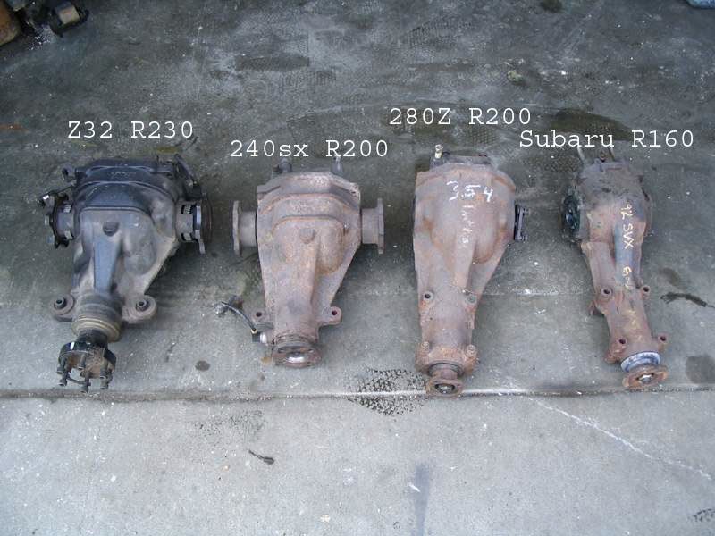

As long as it is an R200 housing swap, everything should fit. You may need a spacer like 10-20mm depending on the nose of the diff, if it’s a longnose or shortnose. I don’t know if I explained that correctly…
the 350z is an r200 dif… but it was not interchangeable… whats the difference between and r200 and an r200v?
R200v is limited slip, R200 is open
Hrmmm, I’m not sure. All R200’s have the same size ring gear, i.e. r200 = 200mm IIRC. So my guess is if it is not interchangeable, then that means the CV shaft design or inputs must be different.
im pretty sure the shaft part of the pinion was thicker then in the 350 then the 240.
