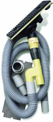

I am either not paying attention or not getting this concept…does the hose from the sander go to the top of the bucket and the shop vac also goes to the top of the bucket? Any access floats on the water…? I’m a little fuzzy today apparently and I cannot visualize this working.

Don’t have it here yet for a true pic but it’s something like that but with a pole sander. Dust goes through water and kills almost all airborne soot, just need to change the water every so often. If you are needing to do any major drywall work its 110% worth the DIY time spent to make it. I can get real pics and specs when I pick it up from him.
http://s3.amazonaws.com/cooltools_legacy/archives/sandkleen2.jpg

Here’s a DIY for the water trap vacuum thing. I’ll be building one before I start my next drywall project.
Then buying this:
Ah…OK. I got it. This will be needed for the coming summer months.
