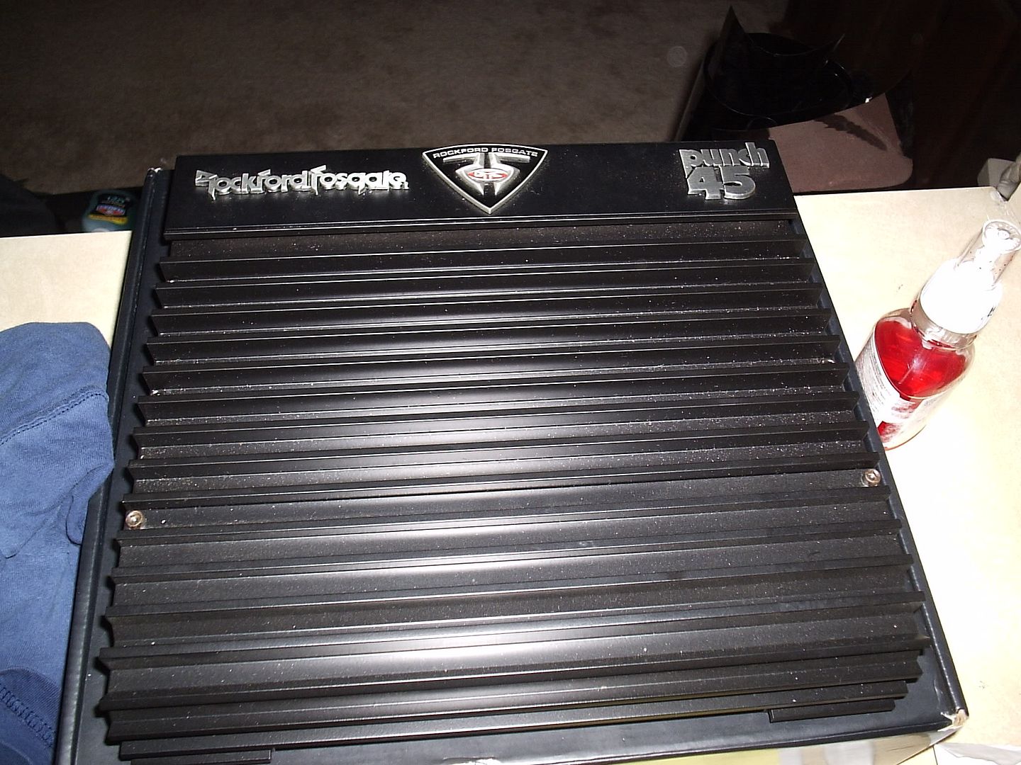

Amps- Rockford “25 for Life” amps. 1 45 and 2 75’s and 1 150

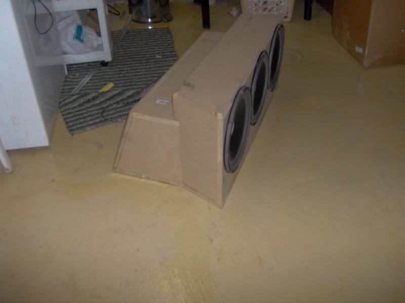

The thing everyones been waiting for sub box/build/install:
Notice the car packed with wood for the box
More to come shortly, finally getting the time to put the amps in, the pic of the amps is just a “rough idea” for how it looks etc.

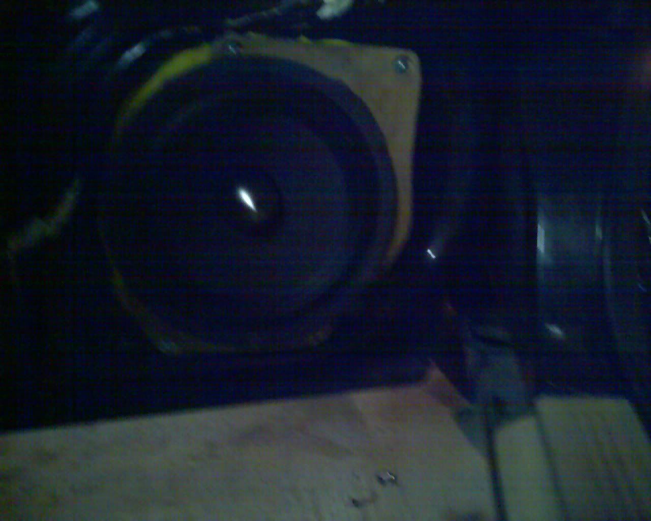

Rear deck got 1-1.5 layers of deadner and then factory recovered rear deck installed with JL 3 ways.
