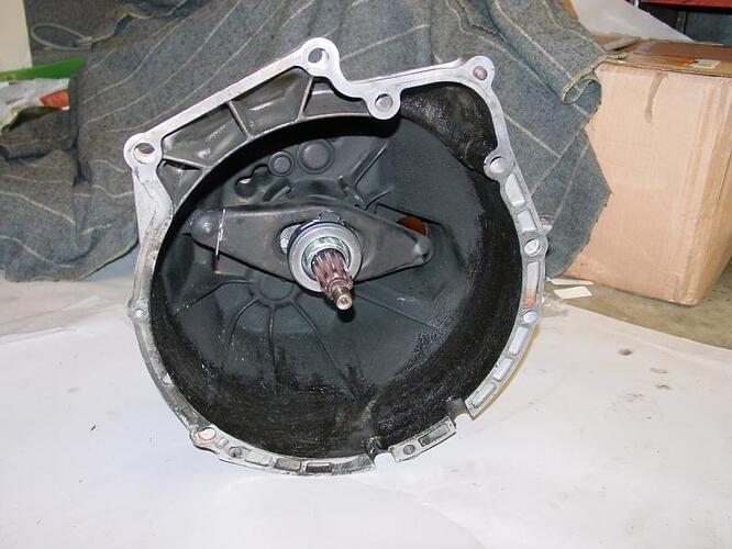

You know it is super easy to put the TOB in 90° out in a BMW… and have it feel like the clutch won’t engage…
the TOB was in there correct…
sitting with the TOB tabs on the 12/6 oclock position,
just like this picture
even in this picture, it looks like there is ALWAYs going to be some back and forth play in there which would be taken up once the clutch cyl is inserted
