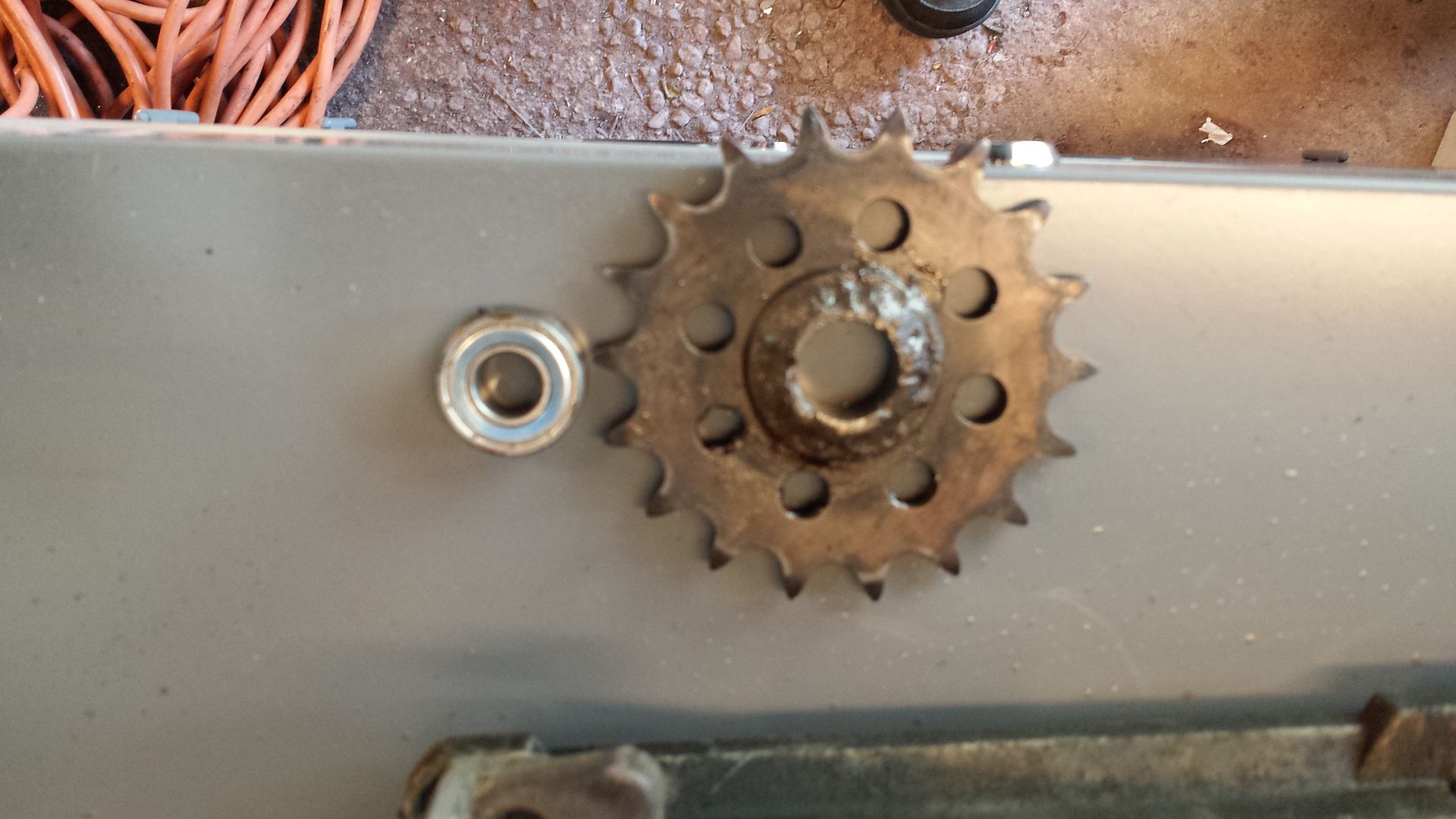

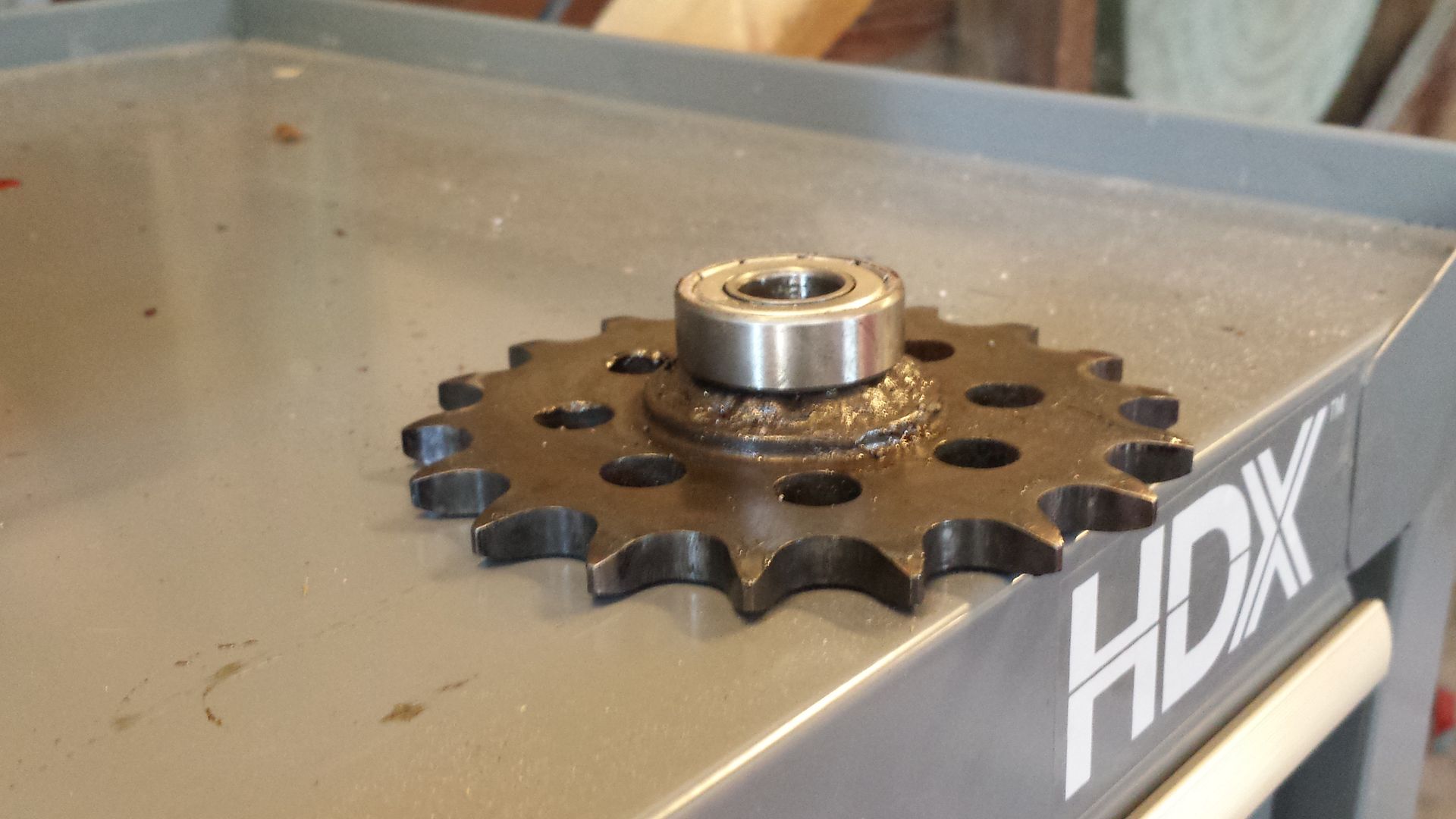

OK, so my initial chain tensioner has essentially failed. (I knew it would just didn’t think it would this fast lol)
I need to use a lathe and bore this sprocket’s center to press-fit a bearing that is 1.125" OD. I previously welded a piece of tuning into the center to insert a bushing…so now I have to cut that out and have a well-centered 1.125" hole in the middle.
can anyone help me out?
Pics of what we’re working with

Whats your plan to keep the bearing from falling out the front or back side? shoulder and snap ring groove? whats your time frame?
I was going to make a shoulder on one side and a retaining ring on the other…or get lazy and tack weld it lol. Another option is to cut a piece of tube that would be a press-fit for the bearing and then cut the sprocket the OD of said tube and weld the tube in.
sooner the better, I’d like to be riding again asap honestly…but I seem to be having a hard time finding someone to help out. trying to avoid paying $40 for a new sprocket to start with.
A new sprocket is only 40 bucks? Or wiuld a new one still have to be modified
new one would still need to be modified, If I can’t get someone with a lathe to turn out the center I have a few ideas how to get it pretty close to do what I need to do, but I figured the lathe idea would be faster/easier.

If you are going through all that work I’d start with a new sprocket. I can probably do it but not till after the 10th or so. It seems like the sprocket is the same thickness as the bearing?
And you don’t necessarily need a lathe. It would be just as easy on a mill. I’d make a jig plate by drilling 2-3 holes to bolt the sprocket to then I can get center from that and also have something to hold it by.
good point bolting it to something else first…
I can do it. Drop it off today.
But only if you promise not to weld the bearing on.
if it’s press fit I promise I won’t weld the bearing on lol. I’ll make some type of retaining caps

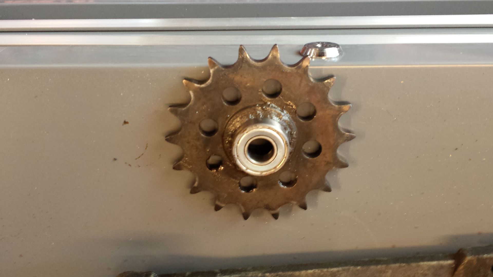

http://img.tapatalk.com/d/13/07/03/6uga6uza.jpg
http://img.tapatalk.com/d/13/07/03/esara7u2.jpg
http://img.tapatalk.com/d/13/07/03/eba8usy8.jpg
:bigtup: Newman saved the day!
so what’s going to keep it from falling out?
a big washer.
Then your bearing won’t really be doing anything, no?
edit: the sprocket needs to retain the bearing so the bolt can clamp onto the center section of the bearing. A big washer compressed by the bolt will just hold everything together as one.
might have to weld the bearing to the sprocket…
it’s press-fit…I don’t think it will go anywhere
Oh. ok. good luck with that.
