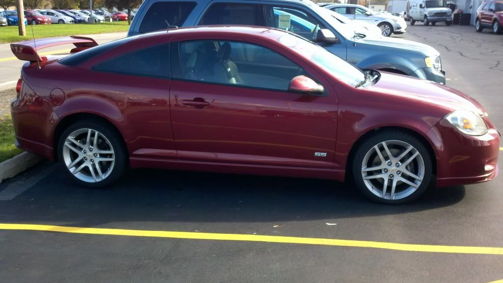

I bought this car from West Herr Ford in hamburg on Oct.29 and have had nothing but problems with it, so much so that im turning the car back in to them and taking something else. Its an 09 Cobalt ss tc with 31k miles on it. The car has thrown a cylinder 3 misfire code since the day i brought it home. Since then, of the time ive owned the car 24 days and have driven it for six of them due to it being at the dealer with them trying to fix it. They first said it was the #3 injector so they replaced it, got the car back and did the same thing immediately. Then i took it upon myself to throw a set of plugs in it, still the same. I swapped coil packs from the #2 and #3 and still got a cylinder 3 misfire. After that i decided(with help from nitroinsane) to do a compression test and found this:
Cyl.1: 150
cyl 3: 130
cyl 2: 180
cyl 4: 150
I tried telling them that there was something seriously wrong with the car but they said they did a comp test and it was perfect(bs). They finally decided to pull the valve cover and found that the #3 valve lash adjuster was broken, i got the car back and it still threw the same code. Finally they decided to replace all the valve adjusters and now the car is occasionally stuttering and hesitating while cruising. Im pretty confident that the kid that had this car before me beat the living fuck out of it and it probly needs a motor. So with that if you know anyone that is looking at buying this car you can tell them to stay away or at the very least make them aware of the issues.
