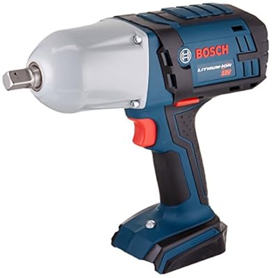

I’m looking at getting a Bosch 18v high torque impact. I already have 2 batteries and a charger that work for this so I’d just need the bare tool. Not sure if I’d be better off just going with a used snap on though.
buy a air cat. This is a tool you will have for a long time there is no sense in buying one that will not get the job done.
edit: they are pretty cheap also
