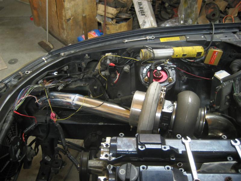

turbo installed. very small clearance with runner #1. for now, i ground off the casting bump 1/2 way around the compressor housing.

building the piping… this will never blow off :biggrin:
had to cut the compressor off and put a 90 degree… gotta love vibrant performance products… i probably just spent $500 in fabrication components
3" vibrant v-band in aluminum
its all tacked and ready to go to the tig welder
