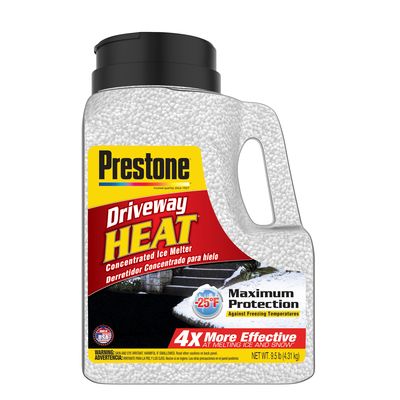

Would this stuff work? I hope so because I sprinkled some on my gutters this morning. There is 6+ inches of ice built up and I’d like to get that taken down some.
http://www.autozone.com/deicer-and-starting-fluid/ice-melt/prestone-9-5-lbs-shaker-jug-driveway-heat-ice-melter/41166_0_0/
http://contentinfo.autozone.com/znetcs/product-info/en/US/prs/AS500/image/4/
MSDS Sheet states that it’s 90-92% Calcium Chloride, 4-6% Water, 2-3% Potassium Chloride, 1-2% Sodium Chloride. This looks very similar to the larger tablets, but just in a pellet form. Might work for you guys who can’t get the tablets.
http://econtent.autozone.com:24999/znetcs/msds/en/US/41166
4-6 % of that product will freeze tonight. You’re adding to the problem.

Is that % really enough to make that much of a difference and when it freezes, it should be off my roof by that point.
Those pellets may help but the idea behind the pucks is to put them far enough up that they melt straight down to the roof and then as the water pulls their salty brine down to your gutter it melts a nice long channel to give the melt water somewhere to drain to. They come in big pucks so they don’t just immediately get flushed down the gutter, instead sitting there on the roof slowly dissolving so they keep the channel open.
The pellets would help more if the temps were above freezing, but on a day like today my guess is they will get washed away as soon as they melt a little water and then the ice dam will just freeze right back up.
That would make sense. I shoveled as much as I could this morning so now it’s just an exposed 1 ft. ice strip across the bottom of the roof line/into the gutter. I just want to get some of it to melt down. I have fake boxed in soffits anyways so if it gets into there, it will still be on the outside of the house.
Take those pellets and stuff them in pantyhose. Lay the pantyhose over the ice so the pellets will dissolve without immediately washing away.
The whole idea around the pelts/melting puck things is temps need to be warm enough to have the ice/snow start melting and dissolve the remaining ice with the mixture.
If its 15 outside and everything on the roof is frozen solid you’re not causing water to pond anyways and once it starts to melt the salt will do its thing
Not true. The whole point of the pucks is to raise the freezing point and get a good melted channel formed. It’s the same reason they put salt on the roads and it melts even though it’s well below 32 degrees. They claim they’ll work down to -25.
Yeah, the bag of Ice melt I just saw said down to -15 and this driveway heat says -25. It was around 0 when I put it down this morning. I figured once it warmed up and the sun would be on it all day, it would start to thaw. The ice is a good 6" above the gutter, so I don’t think I have to worry about it refreezing just yet, it’s going to run off, probably make icicles if the pellets dissolve that quick and I’ll just take those down when I get home.
What im saying is the small amount of melting you get from placing one of those on the roof when its 10 degrees out won’t do that much to deal with ice jams and when its this cold you’re not getting massive ponding on the roof anyways.
However when its in upper 20s and there is a decent melt going which breaks down the tablets and can dissolve the ice jam its hitting.
