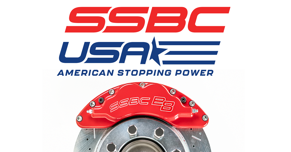

Looking To Upgrade My Braking System ...
the calipers don’t HAVE TO be red … but I think the red would look good behind my rims …
(sorry about the pic being so big)
I was talking to focusinprogress and he said the same thing. That stainless steel lines and brake pads would make a world of a difference. So the SSBC kit only includes stuff for the front? correct?
Depends on the kit. Check their website for application guide:
Some cars they make a rear kit for two. Don’t know about Hondas off the top of my head.
