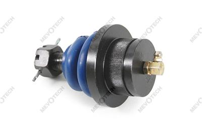

I ordered lower ball joints from Summit. Figured since I was there, I might as well make sure the front is all set. This is the part specified for my truck and what they shipped.
http://static.summitracing.com/global/images/prod/large/MEV-MK8695T_ID.jpg
I borrowed the press tool kit from Advanced Auto and when I pressed the new one in, I notice it bottomed out on the flange before the snap ring groove became visible. Basically it sits flush on the lower control arm. I looked at the Moog one that was originally in there and it was obvious that flange was “thinner” hence the snap ring could be clipped on. I called my mechanic buddy and he said he wasn’t overly concerned and that some older Chevy truck models actually had this type of ringless install.

I know it’s hard to see in this pic but I thought my phone took a pic of the ball joint. It didn’t. In summary, does anyone think this poses a failure problem? I drove it home and I can’t wrap my head around the logistics of where the weight / pressure on the joint is so I don’t know if it’s pressing it in there or pulling it out.
This is a stock internet photo of the bottom of the lower control arm. The ball joint gets pressed in from the bottom and dangles down.
I can correct this situation by ordering another lower ball joint, but I certainly don’t want to go through the hassle if what I have now is acceptable. Automotive knowledge on my part is lacking here.

If the ball joint is in the lower control arm with the threaded stud is pointing down, and the steering knuckle gets bolted on so it’s on the bottom of the control arm, the weight of the vehicle should be pushing it together and won’t pull the ball joint out of the lower control arm. I don’t see a problem with running it without the snap ring but I would definitely put a cotter pin through the ball joint stud.
Thanks for the input. I definitely put the cotter pin in the castle nut. I checked in yesterday and it hasn’t moved. I took quote a bit of torgue just to get it to seat in the control arm so I’m guessing it’s not coming out, but I’ve guessed wrong before. Unless I hear otherwise, I’ll put the other side in the same way. I just don’t want to be driving down the road one day and have it fall out!
the forces from the strut and from the road are both pushing the ball joint “into the control arm”, not pulling. its not critical to have the clip in, but I know it would bug me. I installed some adjustable upper balljoints in my truck and when they “seat” in the spindle they sit higher than the old ones…I know its fine but it bugged me for a few days. guess that’s just my OCD.
