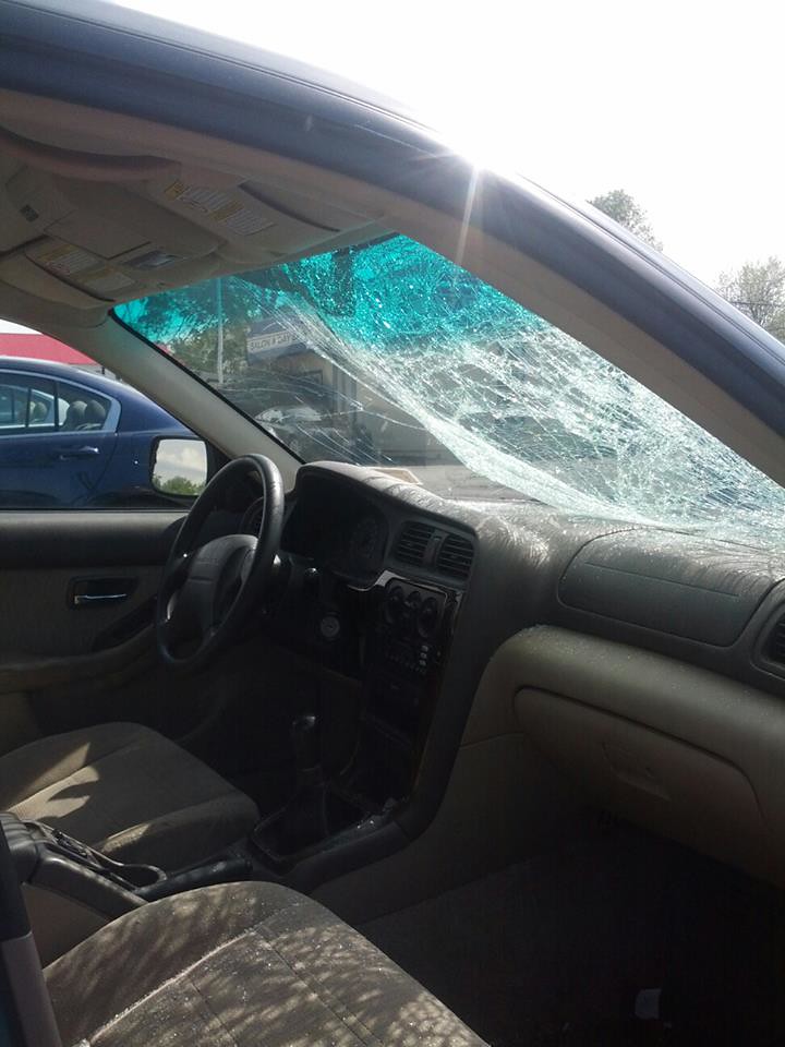

Then, on the way to Pennsylvania (2 hour drive one way) for work at 5am, this happened:
I was able to limp it home for an hour driving like this:
The car has already been deemed a total loss, but 100% of the damage is cosmetic, and the car runs great. I will be buying it back and fixing it. Not sure if I’ll sell it for a nicer beater yet.

Wtf did u hit
The fur didn’t give it away?
Big foot
Sorry about the accident and congrats on the build!
