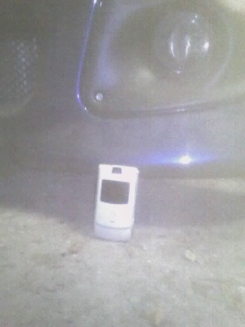

With my brother buying the Vert, and you and this thread… Im seriously thinking about finding another mini.
http://img.photobucket.com/albums/v467/badnewsmini/04%20MCS%20indy%20blue/03-18-06_0013.jpg
@BadnewsMike Do it!
