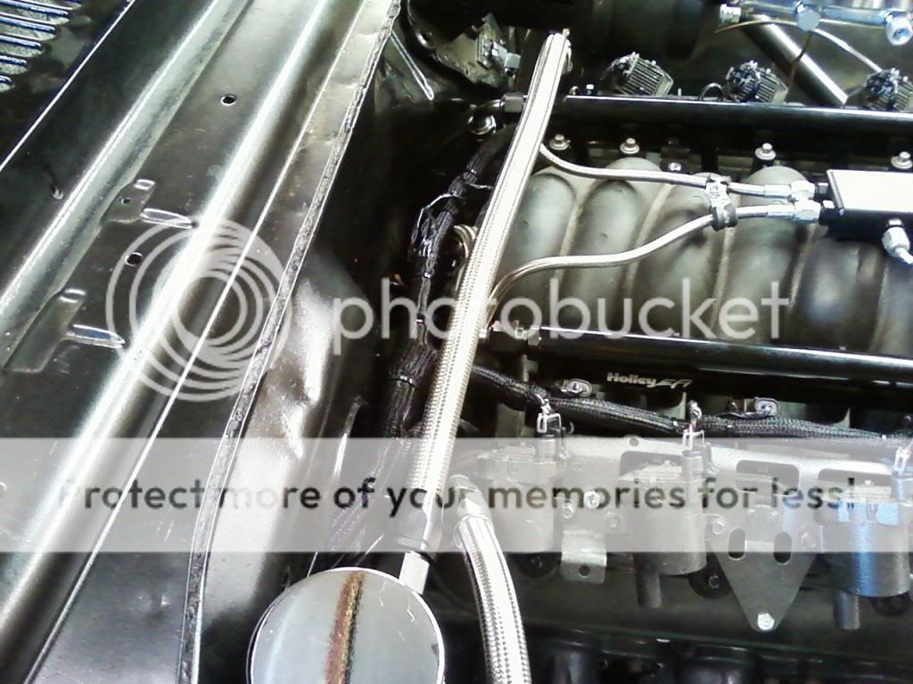

http://i307.photobucket.com/albums/nn302/ablake211/photo31_zpscff6f2b7.jpg
Looks amazing Drew! Nice job!

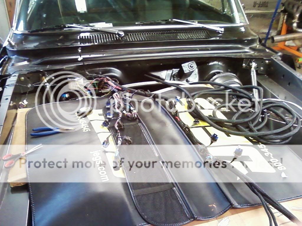

A lot of prep went into getting the LS harness ready for the car…I had to re-wire a few areas, lengthen both O2 Sensors, un-pack and reroute all the OBDII harnessing, and relocate the fuse block.
Once I had the harness on the car I was able to mock it in pretty easily and add in the wideband harness.
Constructing the harness:

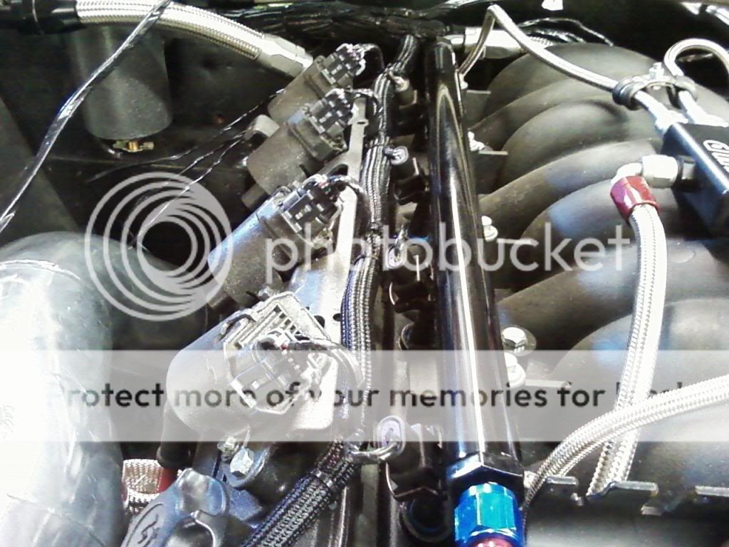

Test fitments:
Final Install:
The Nova Harness was stripped of all it’s SBC content, still needs a lot of love, but should go in without much trouble.
