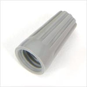

Hell yeah thats how wiring is done in the south boy!
love the 5 wire splice, all it’s missing is this
this thing has a lot of nice little touches to it
