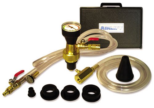

Have you tried this to help bleeding?
http://www.summitracing.com/parts/lil-24680?seid=srese1&gclid=CI7b57TC0b4CFStk7AodfSQA3A
This is a necessity in my shop. I think Carquest carries them in stock. Call and check it out.
Don I have used that once before with and it was excellent. I went to autozone looking for one the other day. Maybe I will just order that from Summit.
Welcome to my snap-on airlift like this anytime. Do a full drain, vacuum it down into a vacuum and suck it full. Works great
drew we’ve got 3 of those spill free funnels at work, i can nab one for a night if you dont feel like waiting. also all the tool guys that come to work carry them for around $30.
I have the same thing gotdubd has. You’re welcome to it
