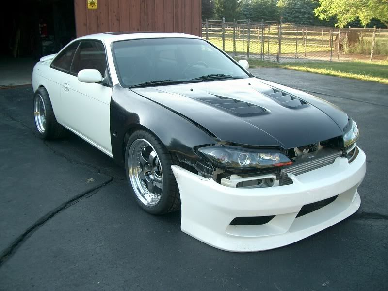

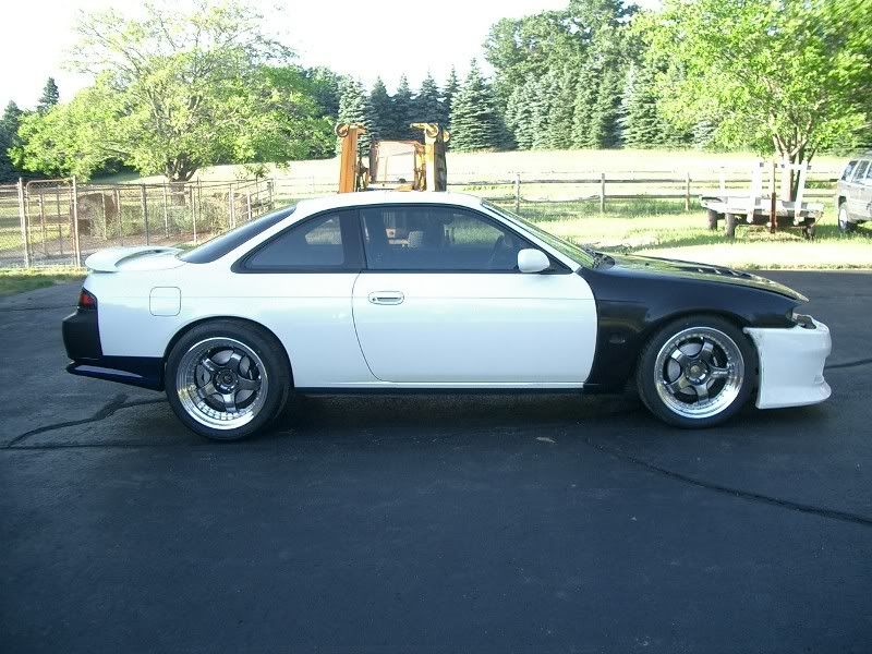

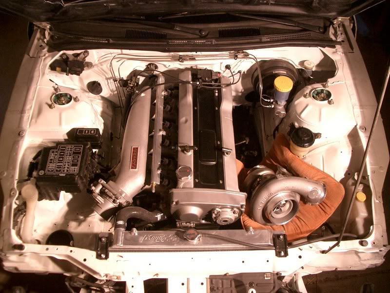

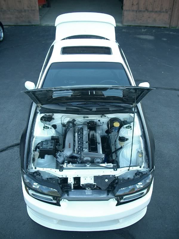

Here’s my car. It’s not done yet, but its getting there. After I get it back from Lovefab it is going to paint and body where I am having a custom rear end done to cover the rear wheels, fenders and hood fitted and its getting a paint new paint job. Same color, Aspen White Pearl.

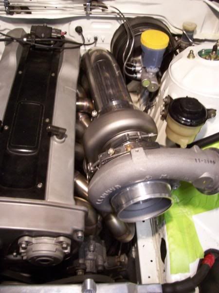

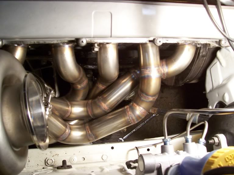

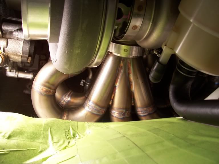

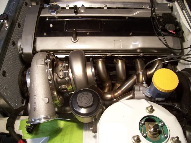

The next pics were taken at Lovefab where my car is currently getting the exhuast manifold made and some other stuff done to it.
For those that are interested Cody at Lovefab will be selling these. The one on my car is the first of its kind. If you want one, get ahold of Cody and he’ll give you more details.

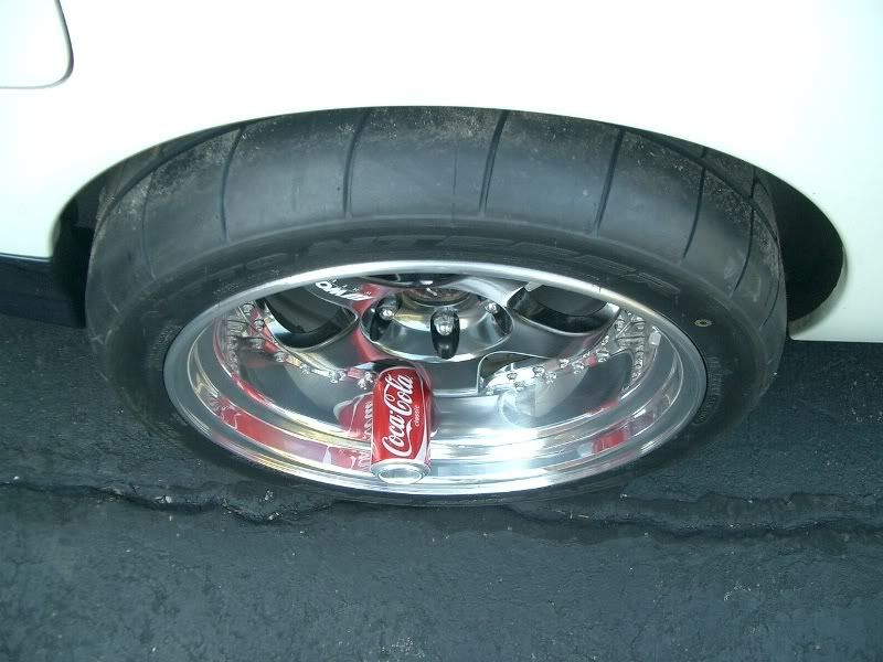

Nice! what size tire do u have on the rear??
nice car man…id love to see more build pics and completed pics in the future ! where are u guys located?
very very nice…what size of turbo is that?

Damn, the car looks gangster.

What wheels are those? work miester s1?
lovefab is in the USA so is this car :slight_smile: also…what size are the rims + tires in the front and rear?
specs on the engine?
is it built? i hope so with that turbo!
i friggin love it, that is really cramped in there for sure
wow, that manifold is STUNNING!!!
haha i like the deep dish… looks like one crazy car… very nice
  1. The wheels are a 18x9 with a +25 in the front, running a 265 tire. The rears are an 18x12 running a 335 tire.
  2. The turbo is a GT42R with Tial v-band hot side

  4. Lovefab is located near Traverse City, MI. They do manifolds/turbo kits, etc.

  6. Stock right now, using it to mock up set up. Fully built stroker motor with fully built head coming soon.
Hope I answered all you’re questions!
