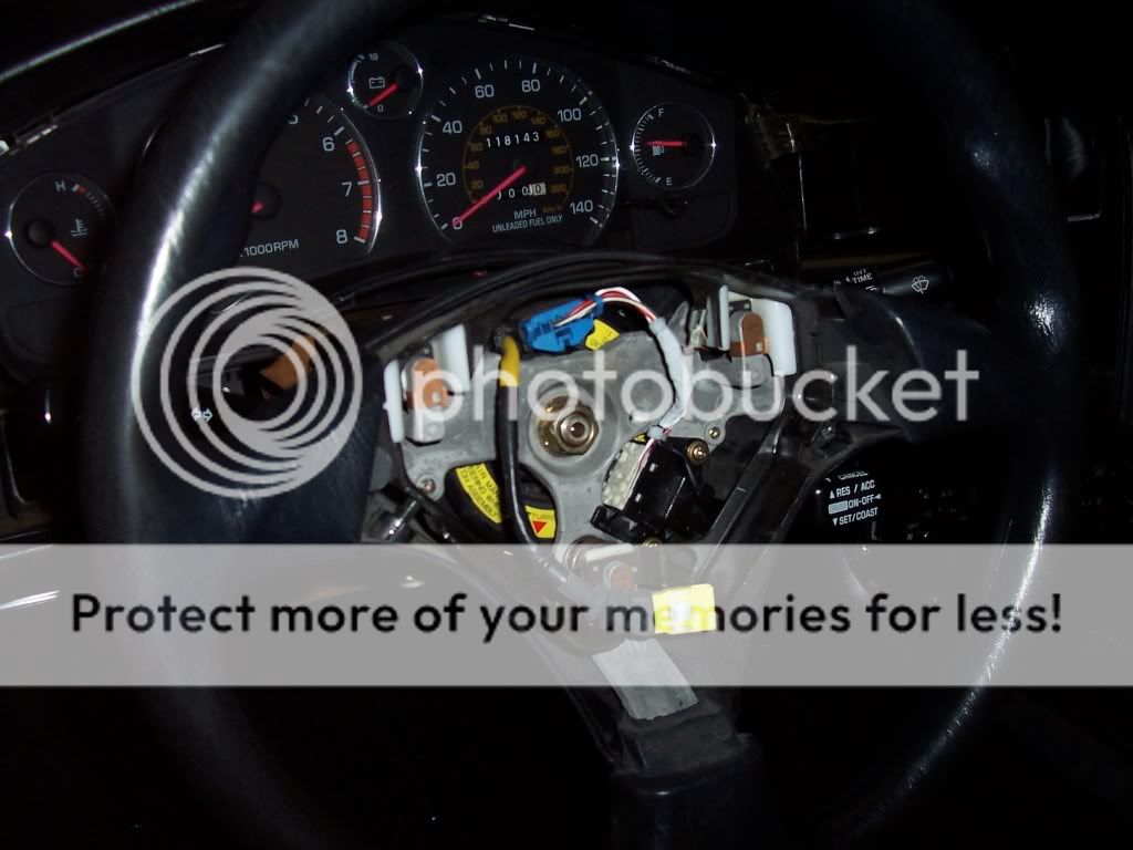

I replaced the steering wheel with a 3 point wheel from an 01 Celica GTS (Airbag not installed in this pic) and Gauge rings:
