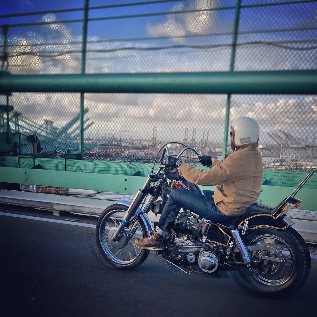

well last summer stopped by to visit the old timer i bought the panhead from
ended up going home with this
pic from a month ago…

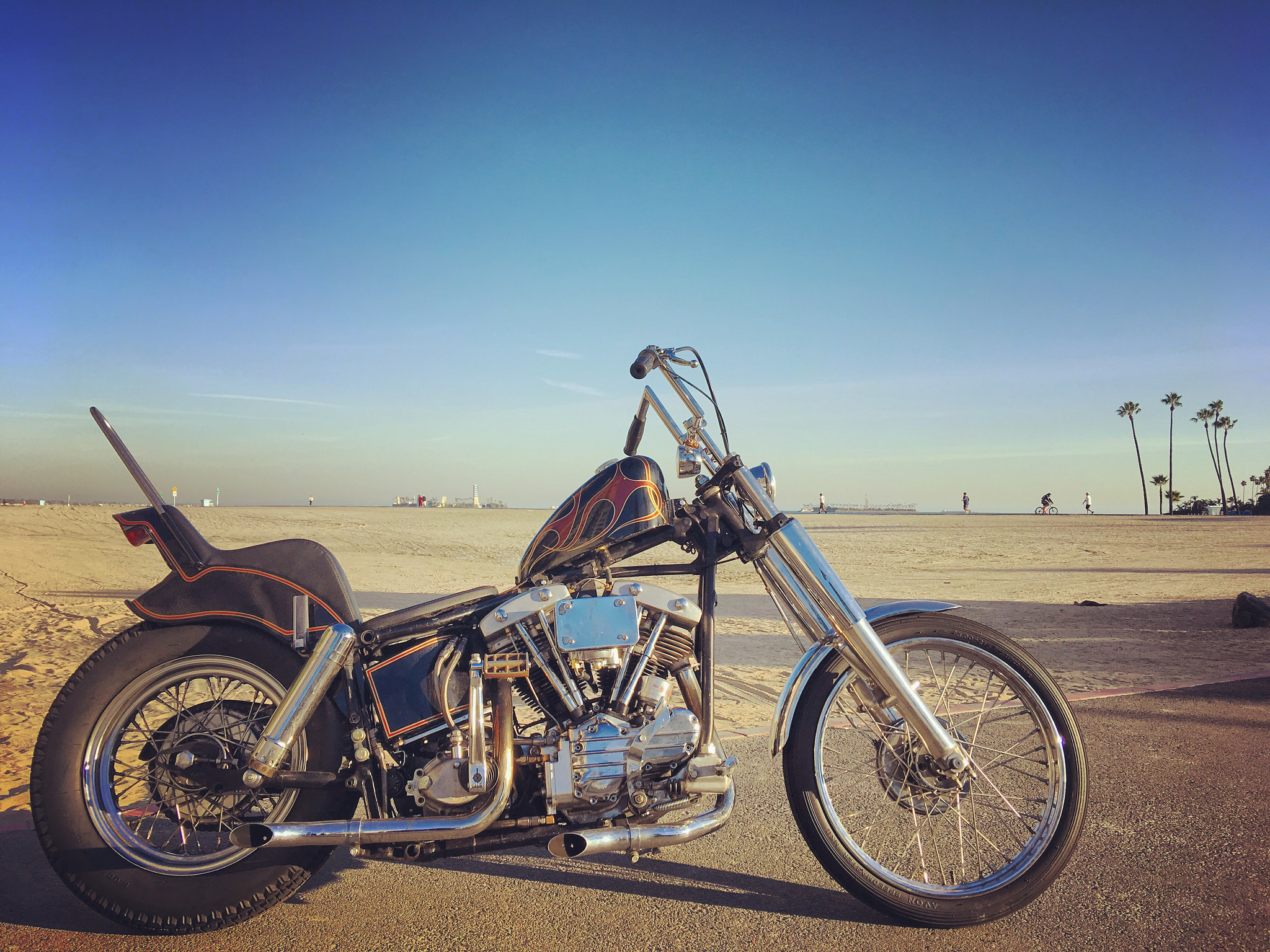

changed it up and went to buckhorns
after the swap on sunday i had some free time to fuck around
[SIZE=2]-swapped the buckhorns back to the z-bars
-dialed in the super E
-added some timing
-went to high mids with floor boards (not sure how i feel about them still)
-swapped the black primary cover for a chrome
-scored a straight kicker arm at the swap so i could ditch the cheesy offset one
-changed out the front brake lever to a panhead blade lever
-took off the tach
-swapped the rocker clutch setup for a regular foot clutch pedal
[/SIZE]

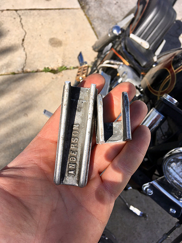

decided to ditch the floorboards and shorten up these Anderson pegs for the front and rear…
drilled a new mounting hole
lopped off an inch
wasnt interested in clearancing the front pegs for them to swing up
took a bit longer to do the rears so they fold up
fin

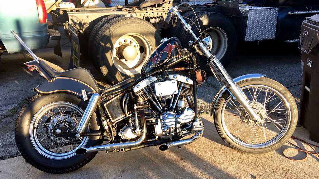

a few nights ago i bumped up my super E jetting to a .0295 intermediate and a .070 main.
i realized i had the accelerator pumped turned out almost 3.5 turns on my previous jetting (.028 and .068)
now its pretty much dialed.

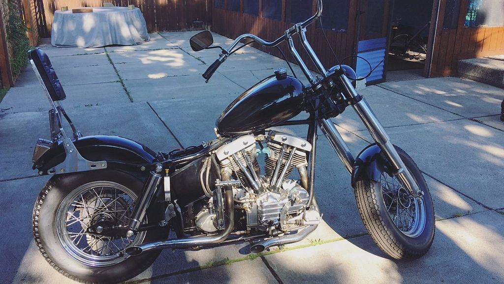

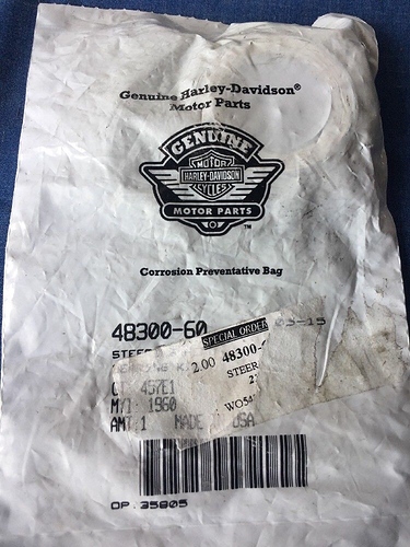

currently waiting to put a slew of parts on the shovelhead.
scored some OEM 1949-1959 Hydra-Glide triple trees that have been chromed and are in great shape
a one off custom one piece riser to fit the early glide 4-3/4" riser spacing

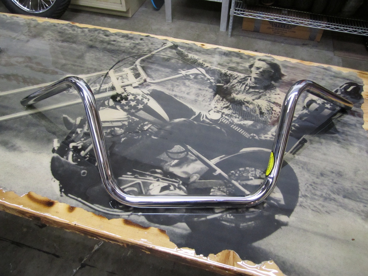

flanders #1 bend handlebars
OE style chrome 49-59 Damper kit…from vtwin (ugh i know but try finding one of these that are complete)
colony OE style rocker nuts (not a huge fan of the knuckle style chrome ones)
OEM lower triple tree bearing, race and dust deal
overall im pretty pumped on how this one is turning out…
