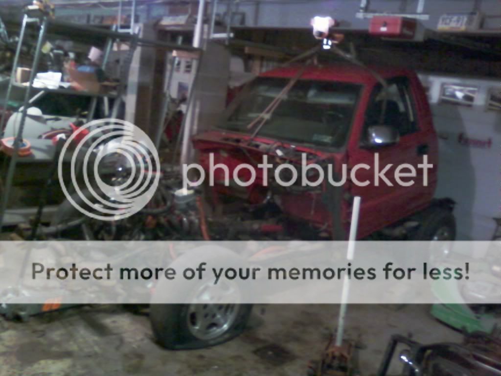

here is some teardown pics

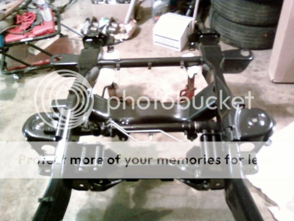

Fresh powdercoated frame and some re-assembly started
Im not the best photographer so cut me some slack!
