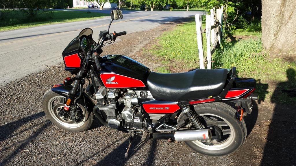

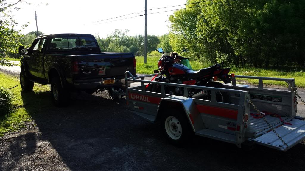

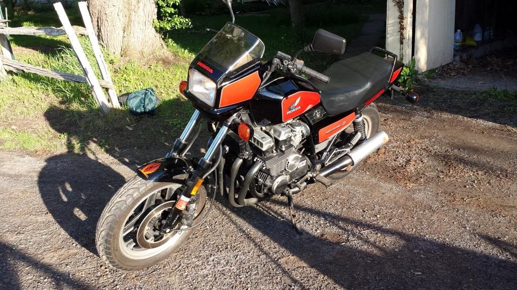

I picked up an '85 Honda Nighthawk 700S in North Greece yesterday, Danger towed it out to my place for me. Should be fun this summer.
700cc inline 4 DOHC with 80 hp, fully adjustable suspension, shaft drive, dual front disks, gear indicator and a 10,750rpm redline.
It needs some updated lighting, but it runs strong and it’s in great shape.

Awesome vintage looking bike
For the price I couldn’t find another bike with the long list of features this one has. Surprising for the years it was produced.

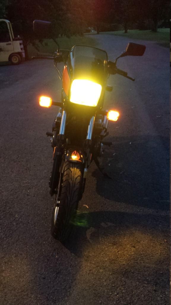

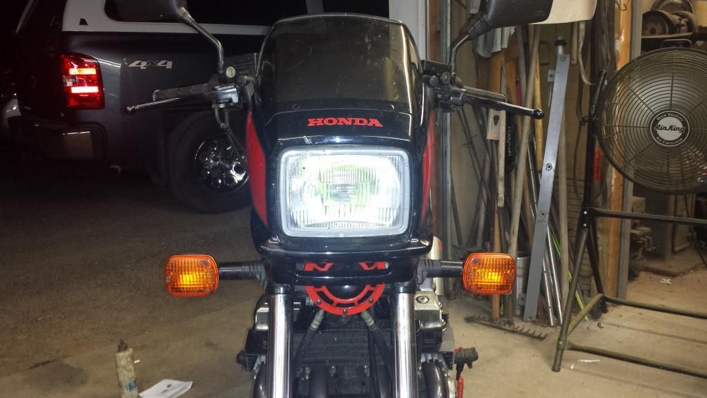

Also installed a Nokya 2500k 55/65W H4 bulb in my headlight, should help people notice me even during the day, and be a pretty nice upgrade from the original 1985 lamp that was still in it.

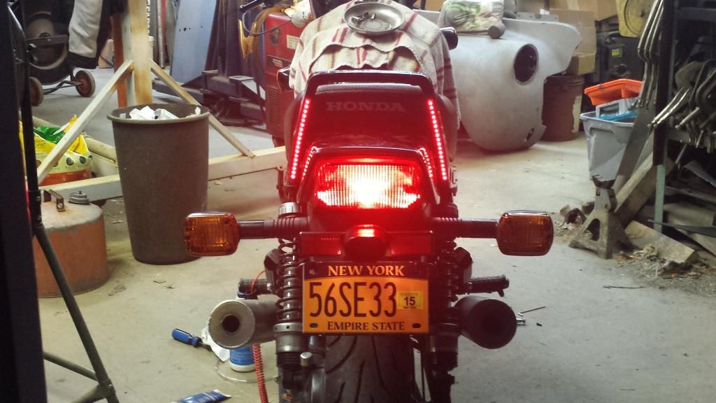

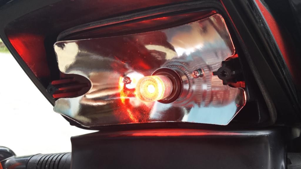

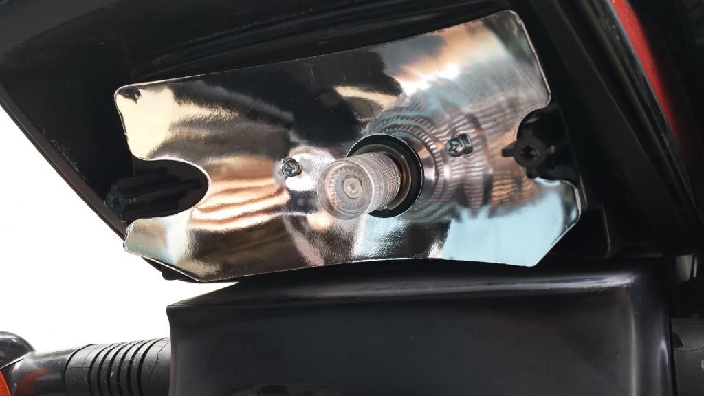

I picked up a flashing tail light from Superbrightleds, it has the flasher built into the led module, so there is no secondary flasher box to install.
http://www.superbrightleds.com/moreinfo/tail-brake-turn/1157-led-bulb-dual-intensity-1-x-3-watt-high-power-led-w-brake-flasher/923/
What I forgot to order was a load resistor, so now I’ve got the tail light warning light on until the resistor shows up.
Installed

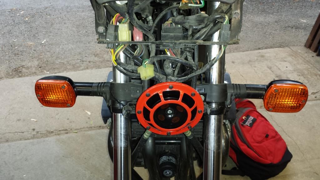

Picked up some Hella Supertones, planned on running just one of the two horns, which was pretty much bolt on. Got this far and figured out the front fairing wasn’t going to fit over it, so I’m toying with ideas to space the front fairing forward just enough for the horn to fit.

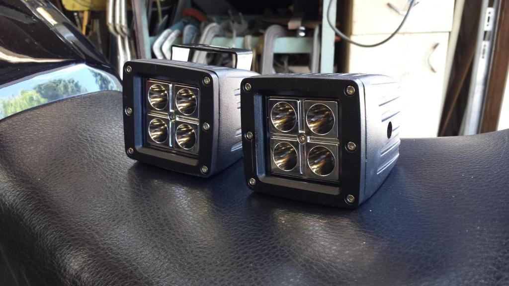

Also picked up a couple LED work lights, 16W per side and should output about 1000 lumins at 12V. I’m planning on stepping them up to 24V which should bring them to roughly 1600 lumins.

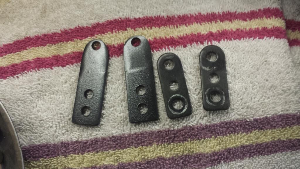

Made a couple quick brackets to space the front fairing forward 0.75" to fit the Supertone. Originals on the right, new brackets on the left. Now it sounds like a truck, haha

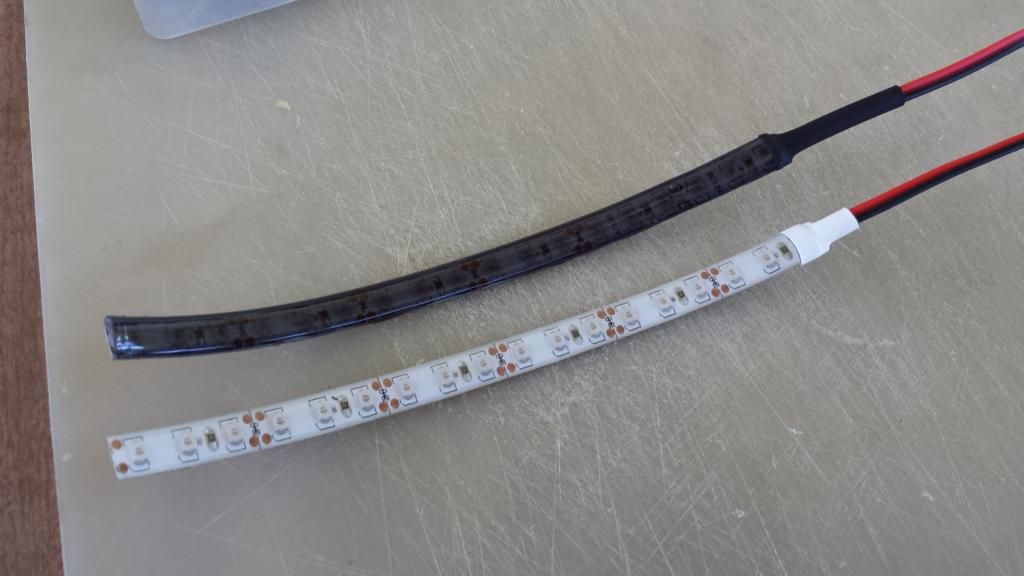

Also picked up some 18 LED 6" flexible waterproof strips. I could only find them with a white backing, so I removed the white heat shrink and applied one layer of gunsmoke Lamin-x and added some black heat shrink.
Installed them on the rear hand bar, wired to the running lights so they are always on.
