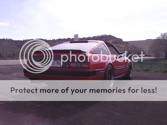

New springs installed
My car doesn’t know how to look emo.
Excellent! Many pre winter drift battle modifications!
Approved. Great stance.
That’s a clean goat. :tspry:
Dude, Thats a beautiful car.
Looks good, hows the rear camber with it like that?
Considering all he did was drop it 20mm… it probably changed next to nothing considering he didn’t do anything to change the stock camber curve.

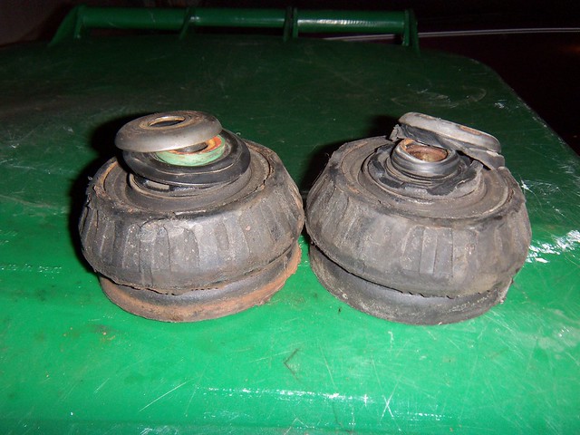

Just finished pairing my stock-height Lovells with Konis this month. Haven’t taken a pic of it now that it’s settled in. Wonder how it really compares.
Did you replace the front upper strut mount bushings? Mine were total crap.
http://farm7.staticflickr.com/6167/6264638105_bd9c4cac1b_z.jpg
http://farm7.staticflickr.com/6100/6347543111_3052eedae2_z.jpg
If not, I’ve got a set of new Pedders bushings and bearings you can have for cheap.

As for the strut mounts, I did the Lovells poly ones not long after getting the car. When I took them out to swap the springs they looked just like new. Those rubber Pedders ones aren’t going to last much longer than the stockers so I highly recommend going the Lovells poly route instead.
Good to know, 'cause I put in the Lovells one this month.
