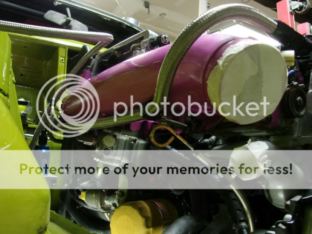

Got the transmission in today. Not as easy as I expected, the little bump where the starter goes contacted the firewall. I had previously only installed the trans with no clutch, so it could slide nearly straight up. This was not the case now, but it went in without TOO much effort. Starter went in too.
I also permanently mounted the brake booster as well as the clutch/brake pedal assembly.
Lastly I made up the last piece of the fuel feed line, had to order a few parts from summit to finish up the return, but I know where I am going to mount the regulator now…
I feel it’s little stuff like how you mount the lines that really makes a build good… I hate zipties and loose hoses.

Oh please god tell me you are not just going to use the shitty, taped factory engine harness? That would be the ultimate sin with this now…
I’m not sure what I’m going to do to the engine harness, but i will probably not leave it taped. Maybe some braided split loom…
You seriously couldn’t find a cleaner dipstick? Or at least clean this one up, or paint/powdercoat it to match the rest?
