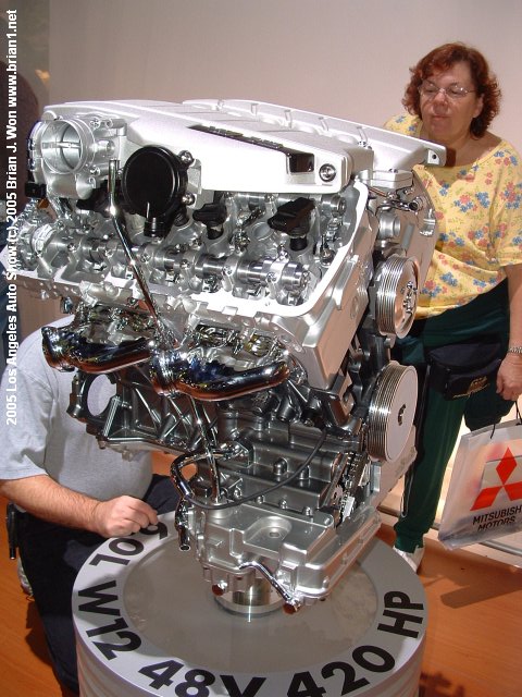

Found these two:
[quote=“9c1,post:11,topic:24596"”]
Found these two:
[/quote]
:tup: Great find. The first is the “study” engine, the second is the production motor. That is an engineering masterpiece.
