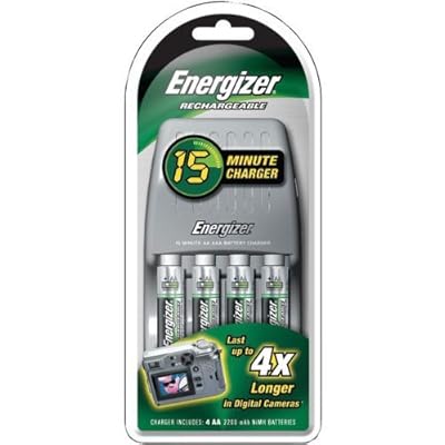

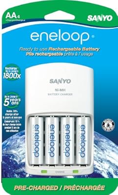

So I picked up a canon 430exII speedlite and I am enjoying using it but I do not enjoy buying batteries 24/7
What do you guys use to power your speedlites? I really like the 15min charge batteries but some say they are junk
Here are my options
thanks
Standard NiMh AA’s can’t be effectively charged in 15 minutes, and that kind of rapid charging tends to dramatically decrease cycle life. Get 2+ sets and simply swap them out. I always carry 4 sets of AA’s in my camera bag. That way, I have no need to charge them immediately.
I vote Sanyo Eneloop’s and BC-700.
thanks man, have you used the eneloops before?

I’ve been using Eneloop’s in my SB-600 for quite a while, and it cycles faster than with alkaline’s. I can leave them sitting in the flash for months, and it still works fine. When I start to notice the flash slowing down, which is usually quite a while, I just pop a new set in. More often than not, I run my flash at 1/1, and I can get quite a few shots before it starts slowing down.
My dad runs Eneloop’s in a 420EX, and it cycles slow, but its about the same as with Alkaline’s.
