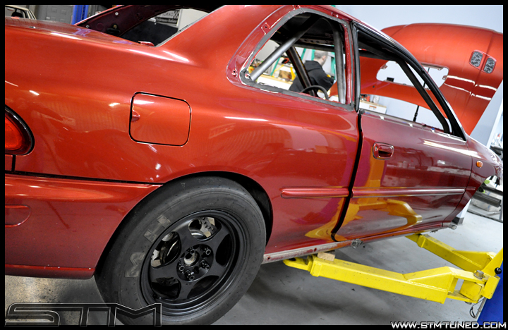

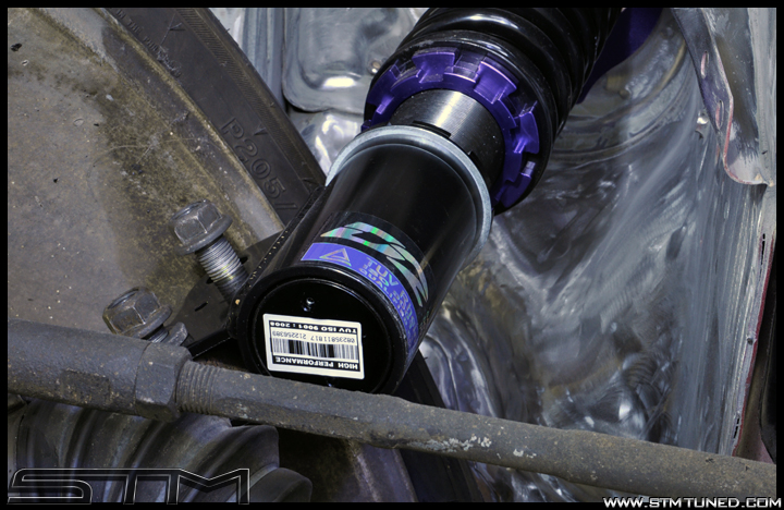

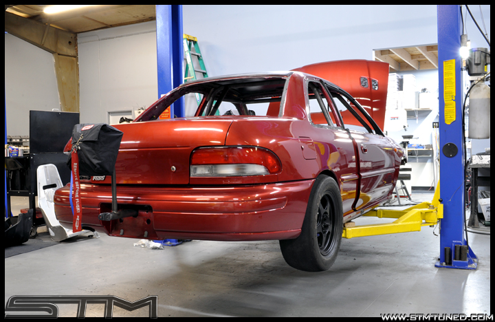

Did they wire wheel the inner fenders? Thats…actually a smart idea.

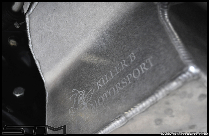

Killer B Oil Pickup as well?

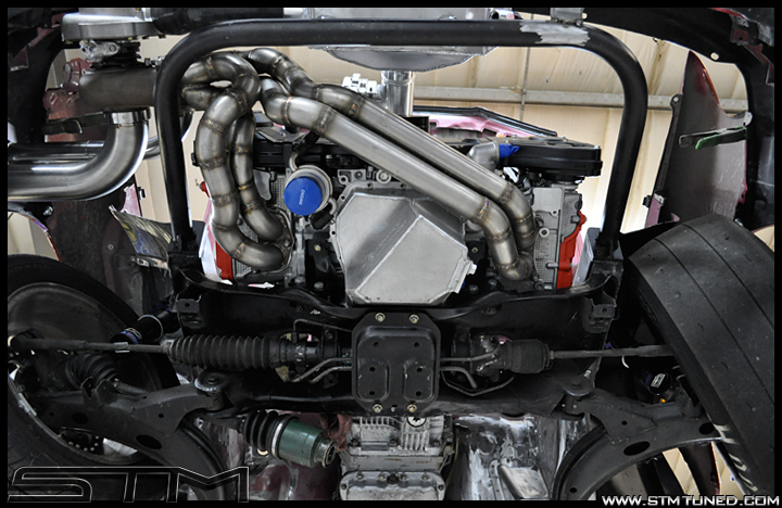

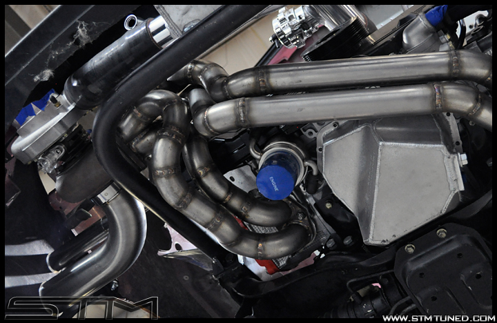

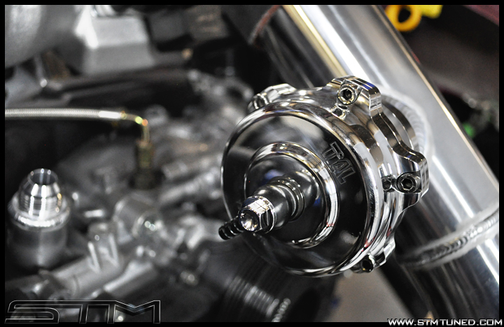

There are a couple of reasons for going this route:
- Being a drag only car, which is seeing boost for only 10 seconds at a time, an air-to-water intercooler is a very practical and very wise route to go in that there isn’t much time to allow for heatsink as well as there is the option of using an icebox to create very low IATs, where a air-to-air intercooler may show signs of heatsink by the end of the track.
- While using the water-to-air intercooler, a lot of space that would normally be dedicated to a huge air-to-air intercooler is now freed up and potential weight has been shed.
- The last good reason for this is pipe length/bends. As you can see, we have very few bends and major direction changes in this setup - if we were to use an air-to-air intercooler, there would be more direction changes (like a complete 180* turn coming out of the intercooler) if we ran an air-to-air setup.
I will do my best to post some more pictures for you to see the setup. The car’s purpose is drag only - it is going to be about as light as possible, and it’s going to go FAST (and hopefully never see the streets.)
If you have any more questions about the car, please feel free to shoot me a PM or call the shop.

Yes, we did strip off all of the factory undercoat in the name of weight savings. Don’t worry, we will be spraying the underside of the car to protect it. I’m sure just the air in Rochester is enough to rust a car.
---------- Post added at 02:39 PM ---------- Previous post was at 02:33 PM ----------
Indeed; Killer B V2 Pan, Killer B Oil Pickup, and Killer B Baffle.
You got it!
Killer B Oil Pickup, Killer B Baffle, and Killer B V2 Pan.
