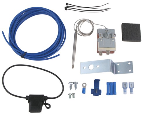

Couldn’t I just wire the pump to the thermo switch? Like this one
http://www.moroso.com/catalog/categorydisplay.asp?catcode=29012
And what temp would you run a LS1 at?
Would a thermo switch for a ele fan kit work too, its just a fuild temp swtich, you could use a adjustable one like this?
Not sure about that derdale 16769 setup (only 10* difference, not sure how “fast” that switch reads) but that idea to set it up with some adjustments. I can see it kicking on, and getting hit with cooled fuild form the rad. in 2 sec. And kicking off… repeat…
I would think you could move the senor so it wasn’t right near the pump outlet obviously. But I can see it not working as easy as a system, as the switch info says. " turns the pump on at XXX and off at XXX, Bingo! thats simple"

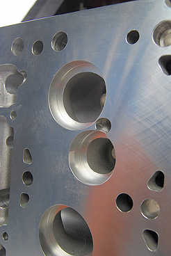

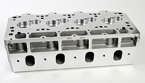

OT- does Edelbrock make a high flowing LSX head now? I haven’t been in the loop for a while, but that seems like a serious setup in the first picture, and I didn’t know of any big boy Edelbrock heads out there.

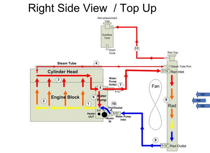

This is the stock LS1 cooling system flow

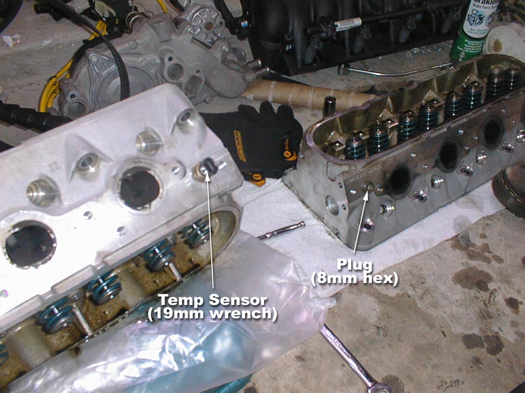

The factory coolant temp sensor is in the heads, The driver side head in the front. The passenger side has a plug that is in the rear
This is the place I’m thinking about, putting the sensor. About at the top of the last red arrow in the diagram. It’s away from cool coolant entering the engine, and around the ext ports and the combustion chambers. The source of heat.

They do, but they started back early 2000ish and GM started making better casting to use for performance, and they never updated them. People would buy them that don’t know any better, finding them in summit or some outdated Espeedshop.com website.
edit, oh the Pic is a E brock casting. But I wouldn’t call it there head, Its a join project they did. Supplying the raw casting they can do in there foundery, But cutis boggs @ RFE did all the ports. The casting has no seats, guilds, pushrod holes or anything really. CFE dose all the work getting it to a killer running head. The shit is badass
http://www.raceflowdevelopment.com/RFD-heads-LSR.htm
Ya I figured they were gone through, or at least a special project. Cool cool
