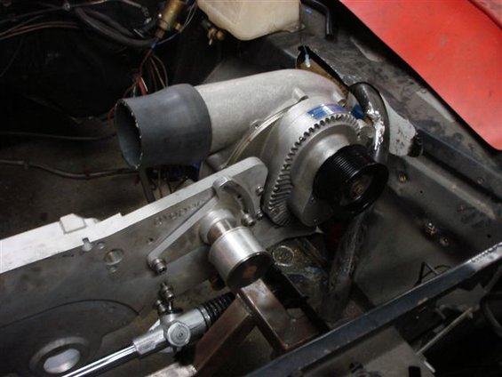

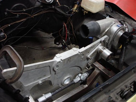

Well it almost got back on it’s wheels last night, next slight (??) problem is monster blower plate doesn’t fit the existing mounts in the engine bay so all that has to come out, along with half of the inner fender to clear the blower, ho hee hum nothing’s ever easy…

and to add insult to injury the front bar of the rollcage is in the way of the blower too, I have a replacement on it’s way from S+W , but until that gets here we can’t do jack $#%@, now I remember why I don’t work on cars much anymore, between this and the Skyline- er well.

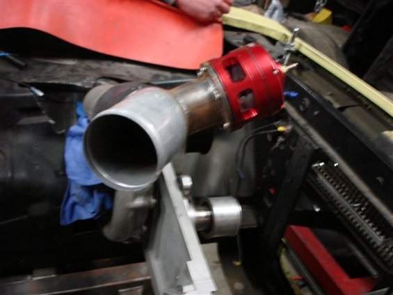

And I’m very pleased that this whole thing will fit together, tomorrow I will get on to Flaming River and see if the right hand drive rack is finished yet, that’s about the only thing that can hold me up now. As for the blower - what I’m going to do is cut the whole passenger side inner fender away and run a bit of 6" from the firewall to the inlet on the blower. That section of the firewall is where the stock heater box and fan fits, so there is a bunch of space behind the dash. I don’t know what kind of monsterous K+N airfilterr I can buy to go in there, but I’m sure they make stuff that’ll keep up with 4000CFM of Procharger!
To answer a previous question the blower is an old D3M unit, they are good for around 1800HP, we won’t be making anywhere near that but I’m sure it will be plenty to scare this worn out old hippy- tee hee.

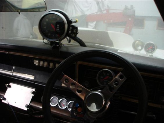

I need to order up a nice big Autometer boost pressure gauge to go up next to the cowl in that cup - hum…
