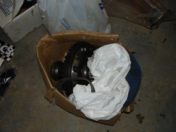

I’m going to re use the 3.54 gears and the spool from the Dart in the new Dana axle, the first gear in the new transmission is a 2.48, so HOPEFULLY we won’t blow the tires off trying to get this lardy old lump away from the lights- we shall see eh?

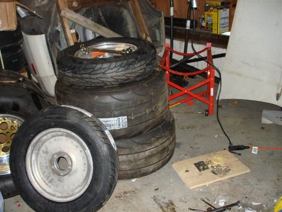

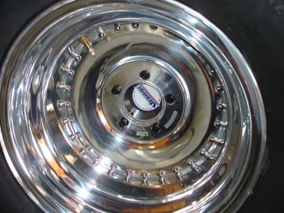

Well the new Mickey Thompson radial front runners are now mounted on the 3 1/2" Centerlines, the relocation kit has arrived to move the springs in and I’ve unpacked the new spring set-up.

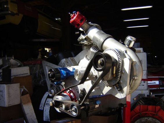

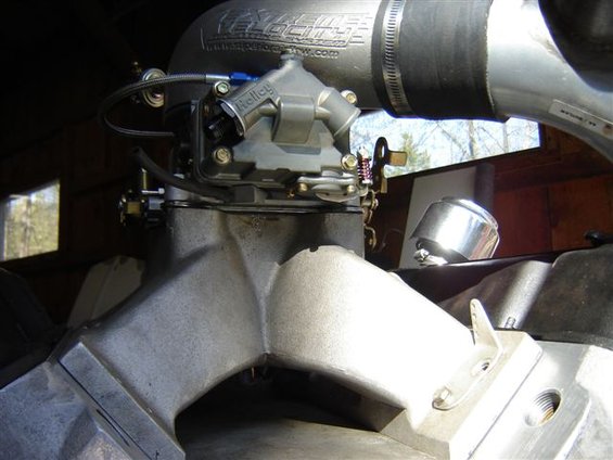

And that my young friends is probably he most advance pushrod V8 made to date, 6 bolt mains, it’s got SIX 60mm roller cam bearings, the heads flow insane amounts of air. Plus the NASCAR guys run their engines extremely lean to get good gas mileage- so they are built to run at very high temperatures. I have a brand new Bryant billet crank for this thing a new set of 8.5:1CR turbo pistons from JE.
We’re going to give the heads a give cleanup and a valve job, re-use the existing Ti valves and dyno it with a special cam we have, get some #'s then start on the turbo set up.
I can only guess what this thing will make normally aspirated, we already know they make around 850HP @12:1CR with a carb!

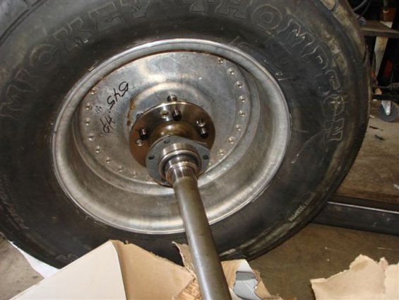

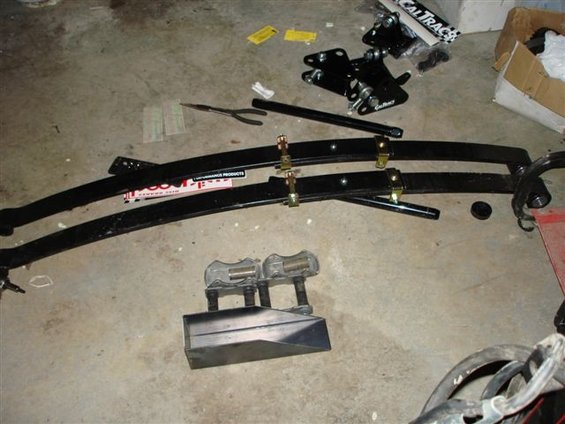

Mopar 3" inboard spring kit fitted ( well tacked in ) Caltracs fitted and look they will work. New Dana 60 axle housing is now sitting on the leaf springs, not sure I have the front spring boxes in exactly the right place and the only real way to find out is to pop the axles in and fit the rear wheels and see where they sit , in realtion to the wheel opening??
We have a B’ body spring in an A body car, with tires way bigger than stock, man what a juggling act this is becoming, I hope all of my guesses are close to the truth.

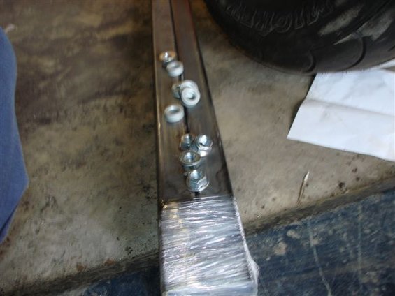

Just got back from the local Dodge Dealership they are pressing the axle bearings on to the new Strange Engineering axles for me and I stopped off at the metal supply place and picked up 2 pieces of 2"x3" 11 guage steel tube, yep it’s new frame connector time.

Maybe we’ll drop the engine in tomorrow, that big old D3M Procharger looks like it grew in the engine bay. I have to take the Plasma cutter to the inner fender though- ooops…

http://www.supermotors.net/getfile/501113/fullsize/3.54-dana-spool.jpg
http://www.supermotors.net/getfile/501114/fullsize/caltracs-1.jpg

http://www.supermotors.net/getfile/501127/fullsize/mt-rears.jpg

Hum today’s the day for getting the back wheels on and dropping the car down on it’s wheels to see if the axle is in the correct location.
Next we have to fabricate the new frame connectors to tie those new front spring boxes to the front torsion bar mounts.
I think it should all work out ok and that 2x3 tube is 11 gauge mild steel so I’m not anticipating much flex- tee hee.
