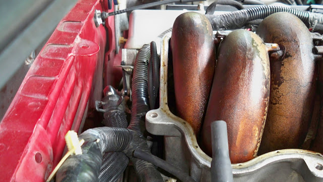

while the tranny was out i deleted the EGR and secondary air injection just to clean up the engine a lil:
before:
after:

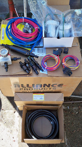

fuel system goodies: -8/-6 feed/return lines, push-lok fittings, and twin GT pumps. i tried to modify the stock basket to hold both pumps but it was a waste of time and ended up just buying a fore fuel hat and 03/04 cobra tank. that tank is on national backorder, i should get it sometime this month.

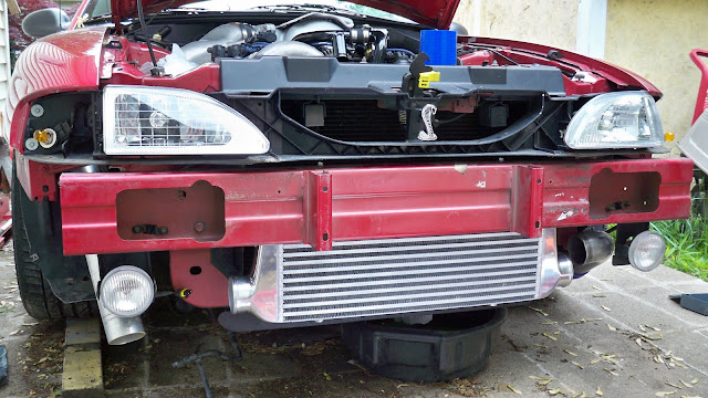

lower FMIC mounts:
lower IC pipe, and modified over flow bottle bracket:

it turns out the blower is about an 1/8th of an inch to close to the block so im starting to chew the belt up on the alternator pulley and its giving me some charging issues. once i get those all figured out, i can start to really dial the tune in and head to the track for some baselines. should be a fun summer! not pictures is how the radiator needed to be moved forward ~.5" to make room for the 4" intake, the passanger side foglight bracket needed to be heavily modified, and the wiring required to datalog the wideband and etc. IATs are awesome with this IC, and most of the piping fit awesome with little work to be done. so far im pretty excited.
