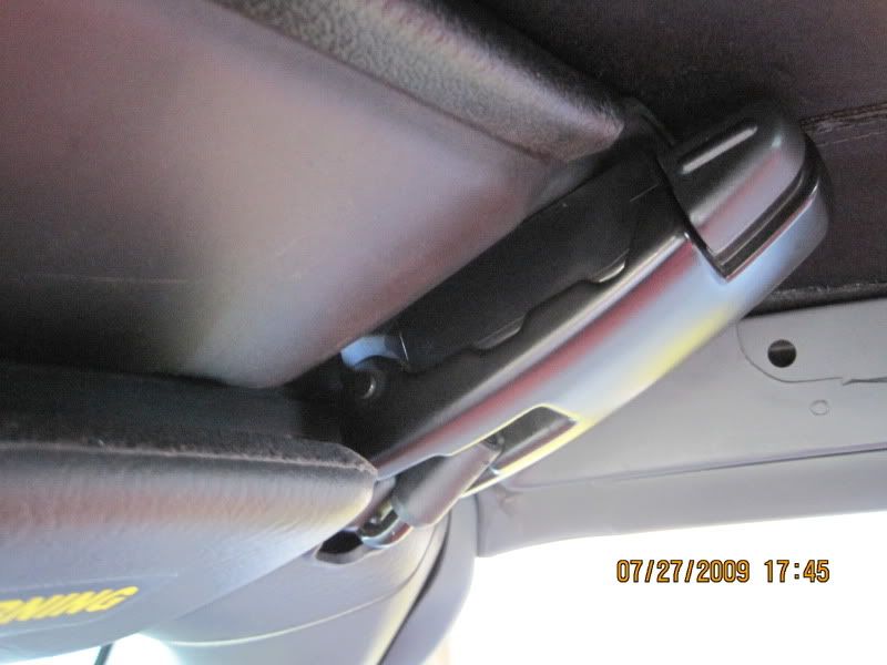

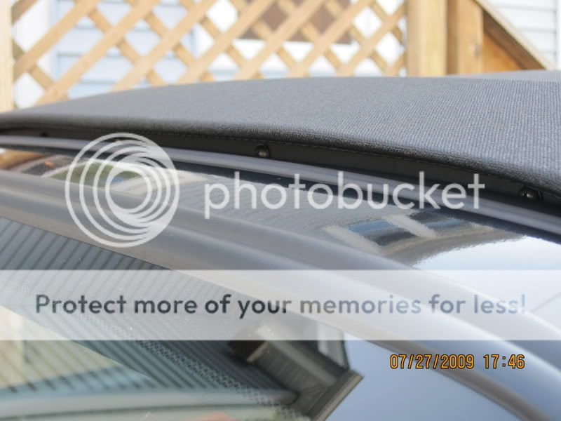

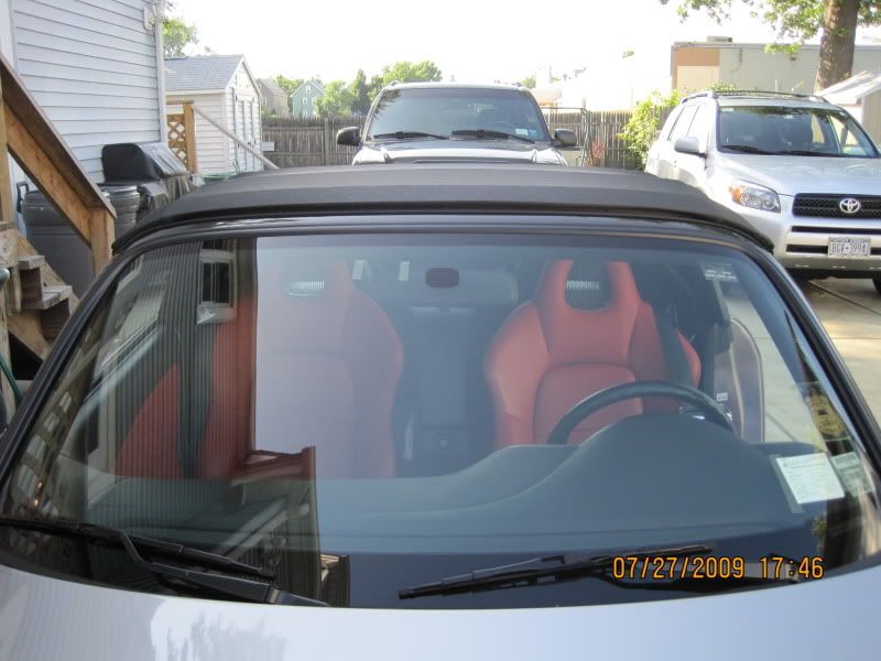

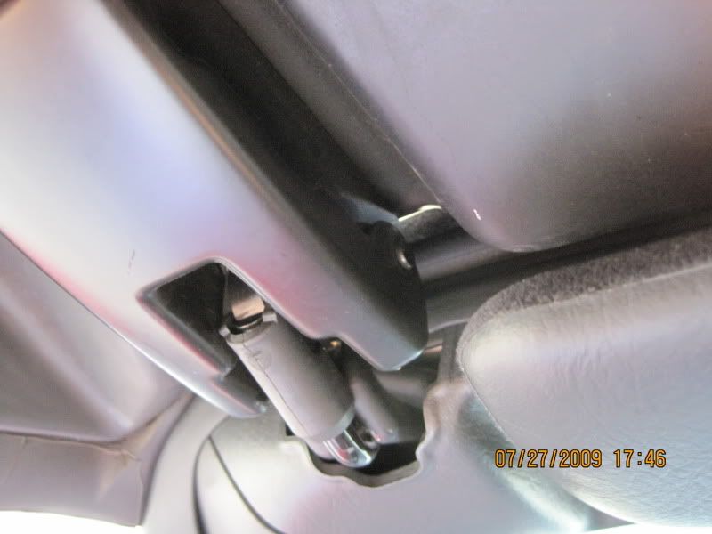

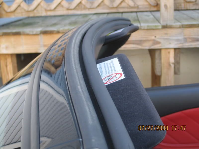

i recently just bought this car and with all of the rain we had i noticed that the roof leaks. while driving water comes through in these little hole i can see, but it also comes through along the whole front side. it is an automatic roof and is completley tight and clamp down all the way. Even when i wash the car ithe water goes through and gets my visors all wet, seats, doors etc. I think it may be the front seal at the top of the car is not meeting up with the roof. Any suggestions?
Pics were the clamps are - you can see the sun shining through…
Gap
Weather Strip

Check to see if there are set screws to adjust the tension of the clamps, I had the same problem when I had my convertible and it was fixed when I tightened them down.
like said above, there should be adjustment on the latches, there should be no gap there. the lip on the top should be tight against the the weather stripping. How hard does you latches close? they should take some force to close…
There is a handle in the middle you need to pull down and probably to the left or right. The top clamps should snap down very easy. And the top should not look even close to that.
problem solved - thanks for your help
