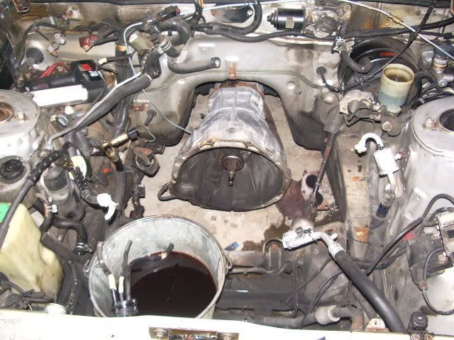

So… We ripped the bitches heart out today
Acctualy everything dident go to bad, she came out pretty easy after the use of a 4 ft long prybar that steve said “was to big” hahah
Now onto cleaning everything up, replacing things etc
AND THE BITCH IS STILL BLEEDING AHHH SHE WONT DIE!
Yeah the motor came out pretty easy. And yeah a 4ft prybar is srs bzns

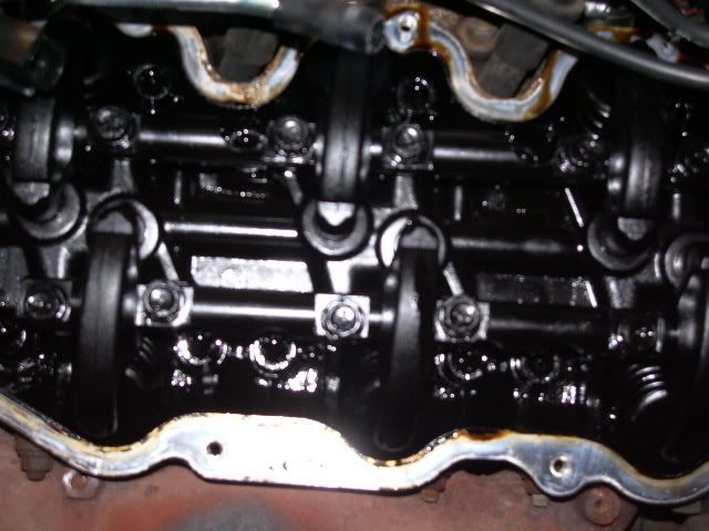

So i pulled off the exhaust manifold… Explained why my exhaust sounded like shit, a nice giant crack going around the whole manifold.
Pulled off the valve cover. Was happy to see that there was no sledge buildup, was not to happy to see that everything looked like it was primered black. After a few ideas were thrown around, came to the conclusion that it was soot/ash from unburnt fuel getting mixed in with the oil and then baking onto everything in the heads. My father loved to run 93 in it, but never bothered to know what the compression was, kinda funny considering he used to build racecars :
There was no buildup of anykind anywhere, and everything looked superclean except for the soot/ash that was baked on over the years, the car has been taking care of its whole life, and it would have to be overheating wayyyyy to much for this to happen and its never acctualy overheated
The camshafts had no scoring on them anywhere that I could see :smile
Pulled off the oilpan as well and everything seems pretty solid, and again no buildup anywhere
Next up is to pull the heads completely off, take some brakecleaner to everything and get it clean and ready for the new cams ;D
