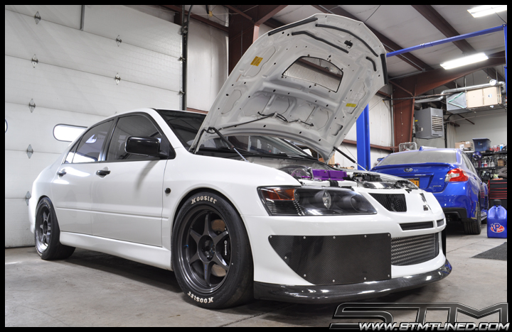

I’d start off by typically saying “Welcome to the STM family,” but this car has already been a member since, 2008 or so, and we just purchased this fine machine. :slight_smile:
If you think we are going to do what you think we are going to do… then we will just make this short and sweet. See you at the Shootout.
2005 Evolution VIII RS. 51,000 miles.
Stay tuned.

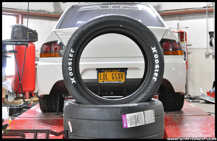

New tail lights, Hoosier drag’s and, really, what street Evo is complete without LOLing at bikes?

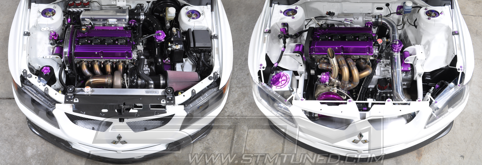

I’m seeing twins! Can’t wait to see these cars side by side! Street vs Drag.

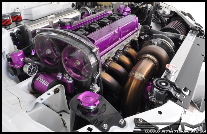

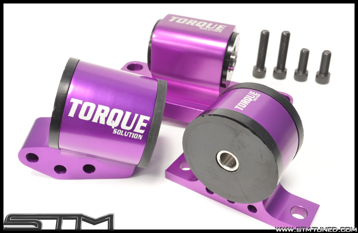

While we are at it, we got in a second set of these custom, purple mounts. Just waiting on the last “dogbone” mount, so if you want these for YOUR project this Spring, just give us a shout! {thumbup}
585-226-8226

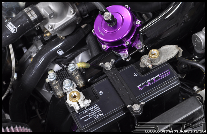

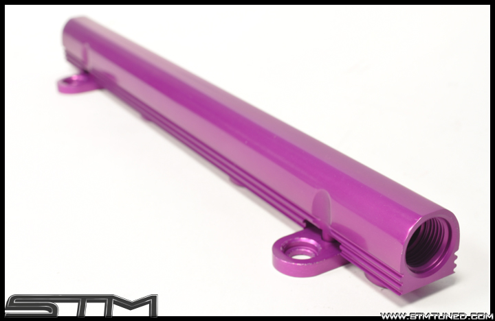

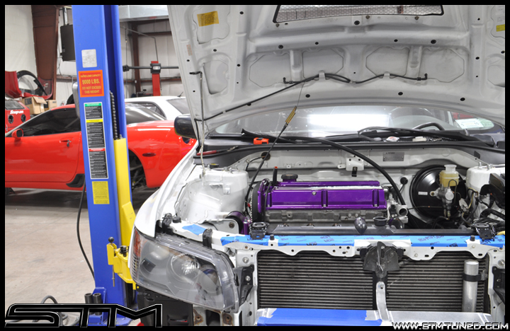

The custom purple Aeromotive Fuel Rail is finished.
http://www.streettunedmotorsports.com/z/stm_rs_junior_2015/stm_evo_street_car8_purple_fuel_rail.jpg
Time is flying by! We should be on a steady stream of updates in the upcoming week!

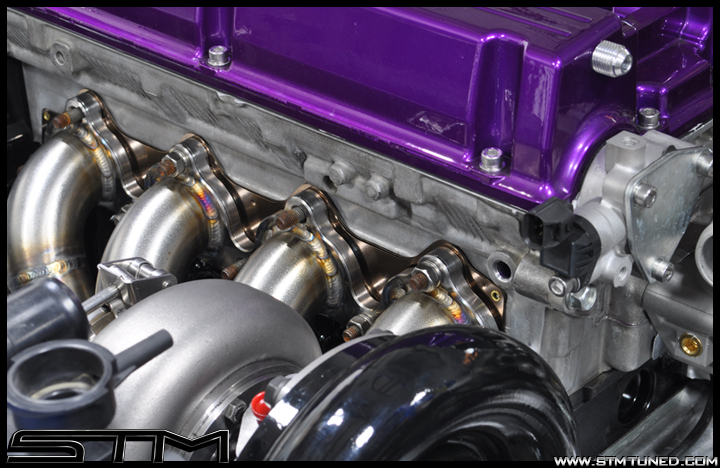

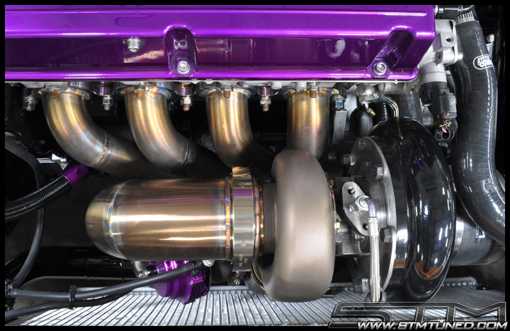

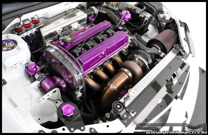

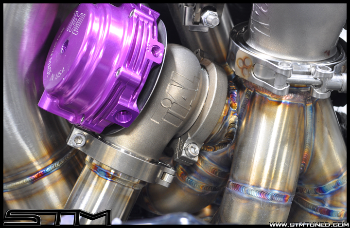

We are fabricating a new, bolt-on standard placement turbo kit for the FP Super 99, Buschur 2.0 LR motor, Shep Dogbox, and “street legal” status.
Texas 2K is Mid-March… so we better hurry up! {thumbup}

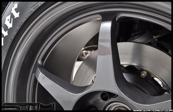

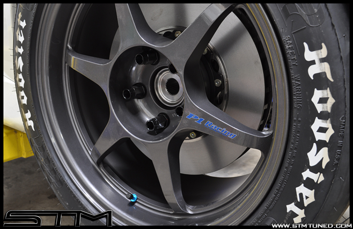

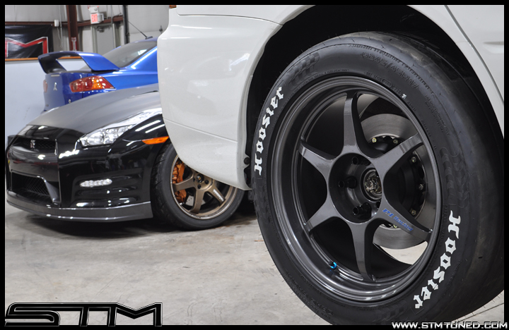

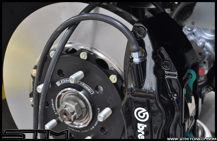

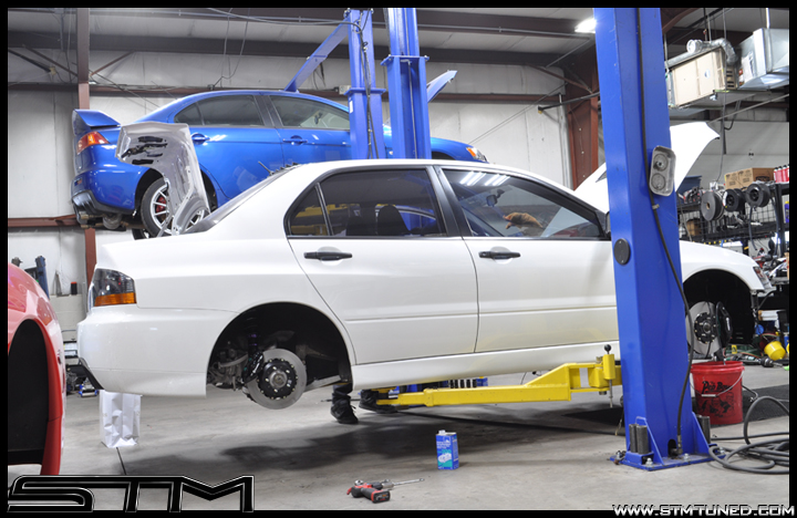

Buddy Club P1 Wheels are in, mounted with the Hoosier Drags.

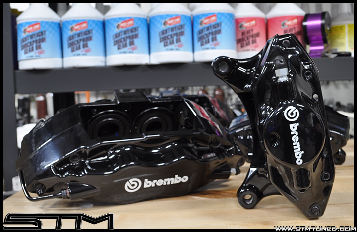

GiroDisc UltraLite 2-Piece Rotors arrived.

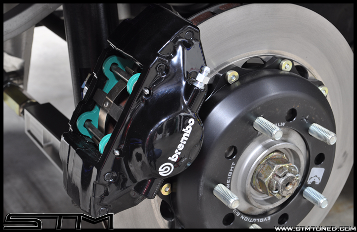

And thanks again to Justin @ Detective Coating for a beautiful job on the Brembos! {thumbup}

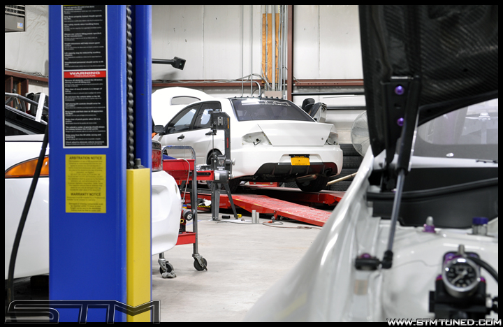

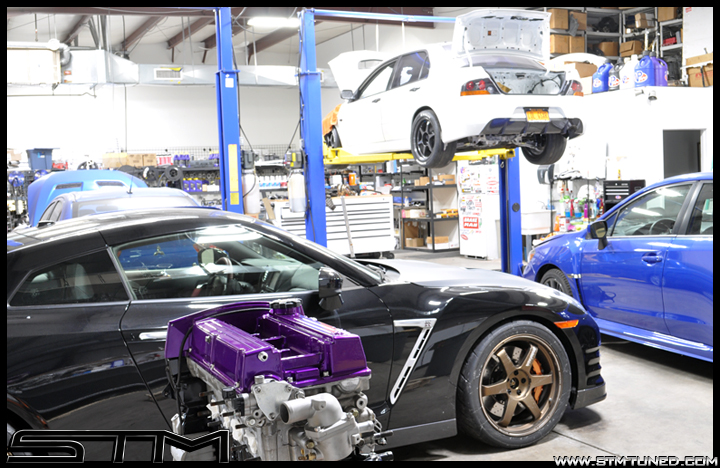

Coming along!!

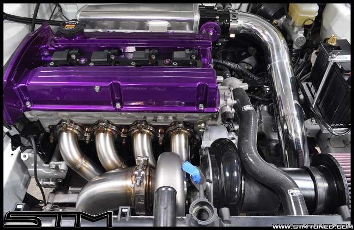

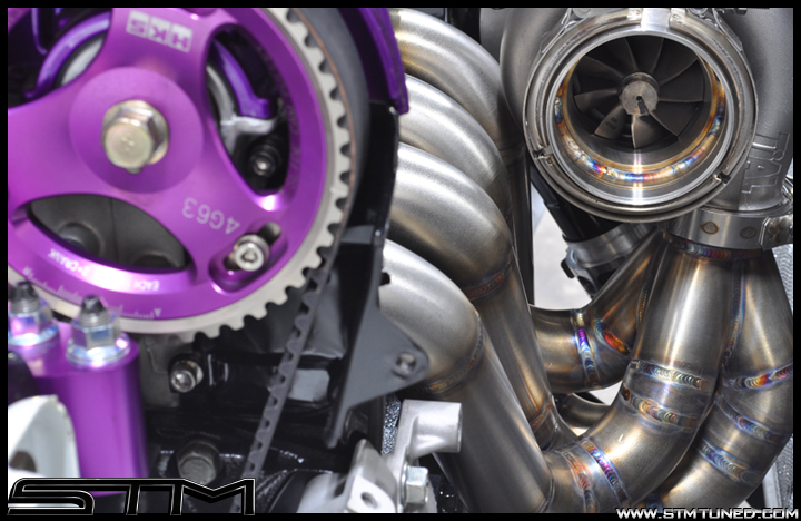

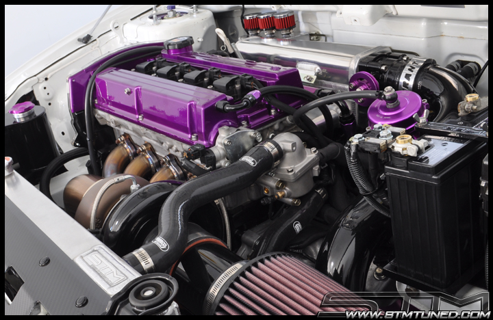

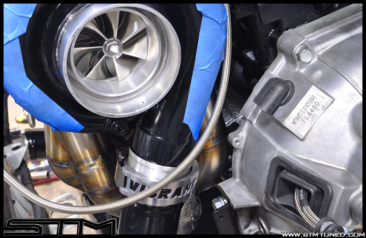

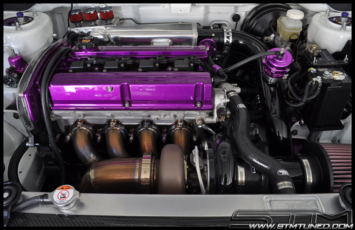

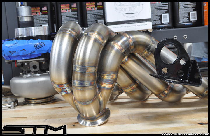

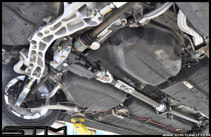

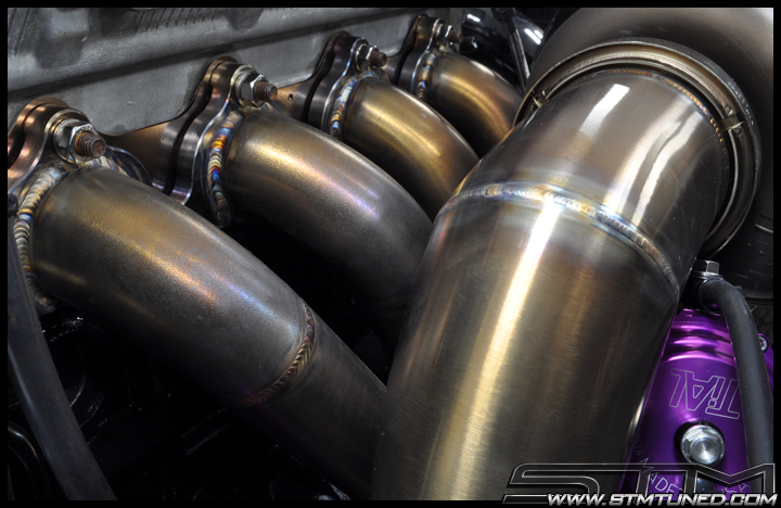

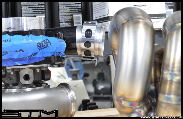

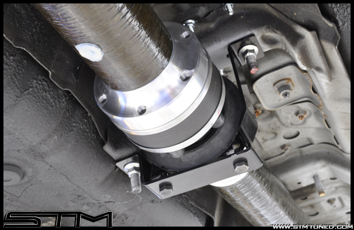

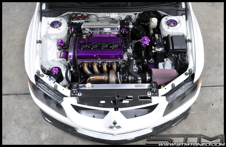

Huge thanks to David for getting us this Buschur Racing 2.0LR is such a hurry! Just about finished with the new STM long runner, top-mount, v-band manifold! The FP Super 99 is looking sexy all black coated! And who doesn’t love a carbon fiber driveshaft? Can’t wait to see it all come together!
And sorry about the Black Edition GTR, it’s always in the way, ruining the view. :lol:

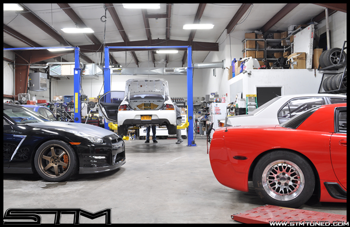

The shop and all the parts/cars are so clean.

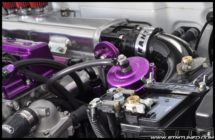

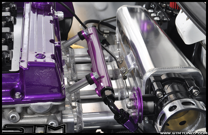

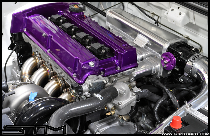

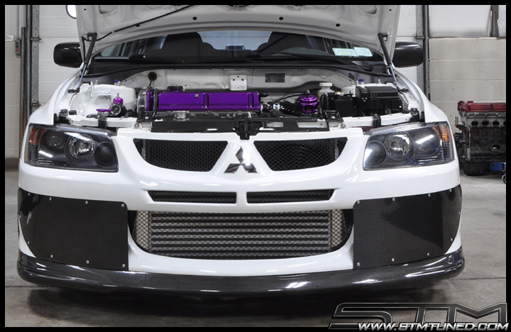

Downpipe and exhaust are almost finished up, Intercooler piping and intake are getting finalized and we are testing out the new Driven Innovations Intake Manifold!

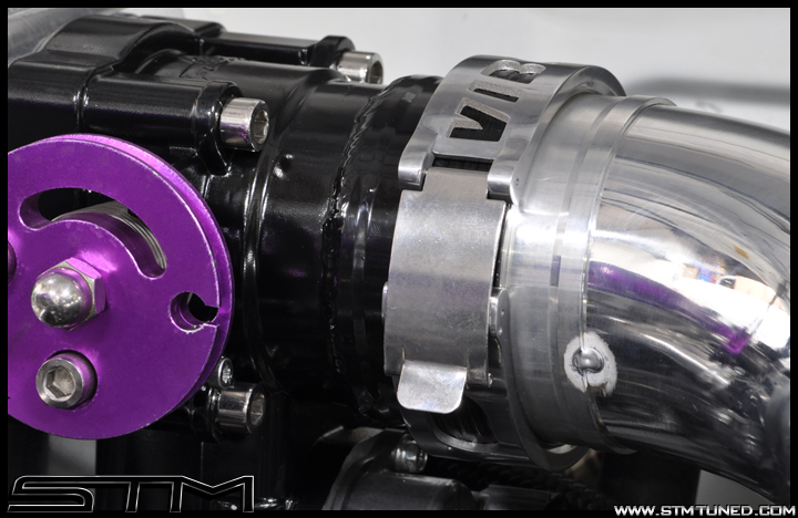

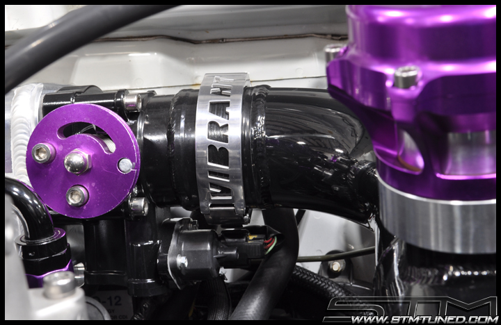

id be careful with those vibrant connectors, my friend lost his motor last year when one of his connectors on his tb broke and part of the connector was sucked in through his intake… from what i gather you should get the vibrant connectors that dont say vibrant on it as the point where they cut out their logo is the weak link
https://farm9.staticflickr.com/8617/16224100533_2a97a53870_b.jpgvibrant by saxonbrian2, on Flickr

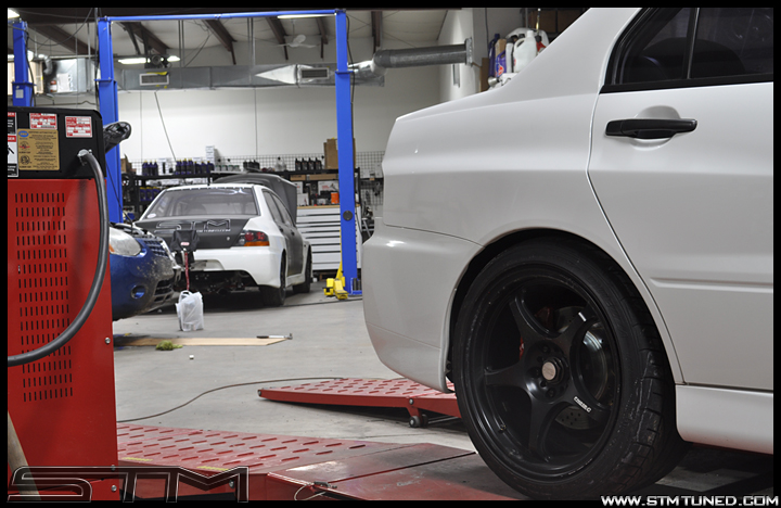

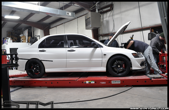

So quick run down. 848 HP and 642 TQ. And Emery says it HOOKS on the street!
He is keeping the parachute on (I know, I know STREETCAR) but safety first. IF it does get squirrely in Texas, he has an anchor.
The dyno printer died, so I’ll get a new one tomorrow and get the dyno sheet up!
Dyno Video @ 784
Plenty more pulls on Instagram!
