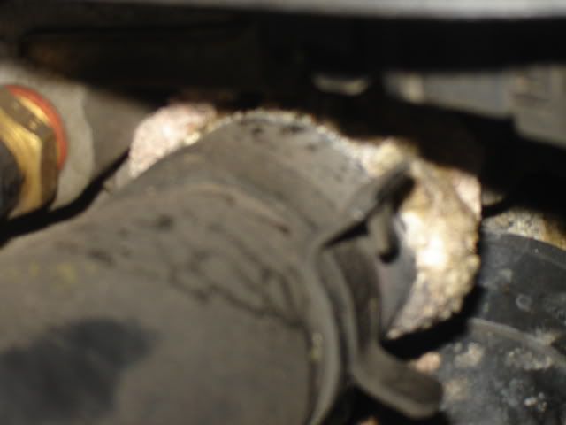

I noticed this on both hoses where they go into the motor:
http://i246.photobucket.com/albums/gg111/PaulJBrudzienski/DSC02338.jpg
WTF is that?

What about the white shit on the hoses- whats that?
white shit is crusty coolant notorious o tension clamped hoses pull the hoses off clean all the white shit and reclamp with a normal worm gear clamp,air can get into sytem if coolant is low or if the resovor went empty it doesent have to come apart trust me put in a new t-stat and refill coolant wit it runnin and heat on it should be ok :nod ;D
