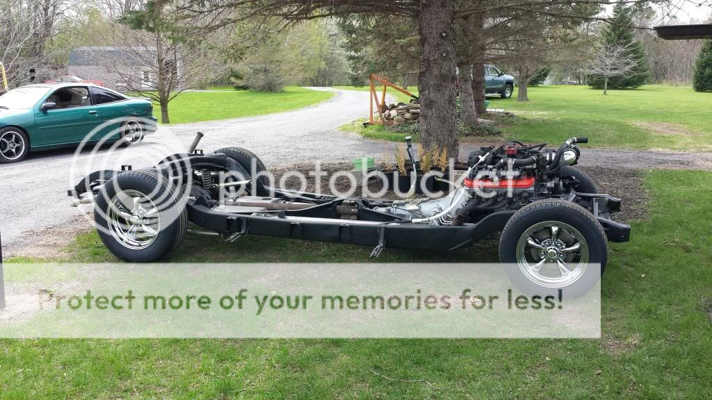

Rolling chassis is almost finished, just need to bleed the brakes, and replace the old crappy power steering pump with a new one, so we don’t fill a $1300 power steering rack with crap. After that the plan is to start it on the lift and run it through the gears to make sure everything is kosher. Who’s got a milk crate? I wanna do burnouts
I’ve been slacking on the updates, Dad has gotten a ton done in the last year, and especially in the last few months.
After getting the rolling chassis finished up, we realized the front geometry was all messed up, there was negative caster, which makes the front end do all kinds of crazy stuff. Cut front upper control arm mounts, move, weld back in place.
