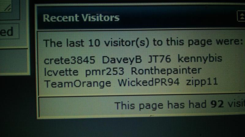

      • Updated - - -
Looks like the one name is chopped off but unless I missed my guess it said jt76
Creepin!!! Hahahaha I think the roles are reversed.:tif:
He’s been busy!
http://i9.photobucket.com/albums/a76/bigjoelster/racestuff/ltx/creepin_zps8f08bb82.jpg
Ha! I’ve gotten WAYYYYYYYYYYYYYYY more visits than you!
92>28
