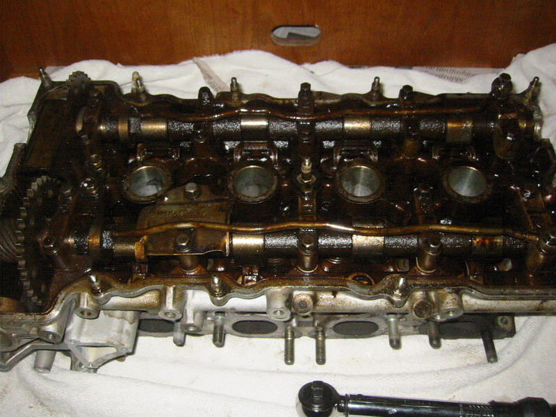

Here’s a quick update on the after-supper progress.
The GF decided she wanted to try her hand at wrenching, so I let her get in there.
She pulled the valve cover, cams/gears, rockers/lifters/shims, etc.
Here’s a little teaser:
I wrote this before I pulled the head.
Once I pulled it, I found something I really wish I hadn’t.
I’m going to need some input.
Stay tuned, the pics are uploading…

Now I find this:
3 of the pistons are beautiful, besides the carbon built up in the middle, it basically wiped off.
But check out piston #2.
It’s destroyed!!
The dark side looks like some pieces are broken off…
The light side looks like maybe possible detonation, but I don’t think so, because the marks/pitts are pretty big, and it’s right on the edge of the cylinder.
Is it possible that the valve shim from April made its way from the head to the combustion chamber some way? I have no idea how it would…
Is it typical for detonation to occur on one cylinder, and only at the edge of the piston?
I should have heard this, or my “knock control” should have picked up on it.
You can see the damage on the head as well.
To add to this, my effin GT2871R is toast. There’s crazy play in the shaft (axial), so I have to deal with that as well. Can you buy rebuild kits for BB turbo’s, or do you need to buy a whole center section? I guess either way it’s going to be expensive.

Very hard to make a judgment call via pictures. It looks like detonation in number 2. Temperatures were too high, piston cracked…end of that.
Also, your cams. Where the hold down bolt up. Are those scores???!!! They look a little excessive through a picture. Have that checked.
If you can get away with de-glazing the bottom end. Do it, if not. Do a complete re-build with some gangster shit!
