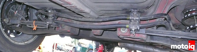

Looks like the swaybar is toward the front? Some LeMony ideas that I would have is;
Double sway bar:

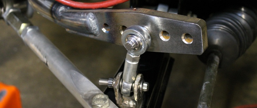

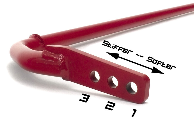

Move the end link for a shorter moment arm, (move the dogbone end link to the other side of suspension/shock motion arm?):

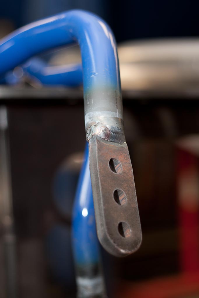

Make your own sway bar (X.xx" dia bar, flat stock, holes, offroaders seem to have more knowledge here):

that suspension setup is very similar to my car. has 8 control arms. The angle on the uppers is a bit different but it does not really matter for your line of questioning. I am loving the double sway bar idea. I will likely do that for both the front and rear if I don’t come across anything else.
