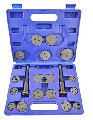

What do you like for caliper wind back tools?
So in the past I’ve used two arc joint pliers to compress rear calipers that hand pistons that needed to “wind” back in. I would apply pressure with my 16" plier (the way I would compress a normal piston) and use the other to turn the piston clockwise. This, however, is a pain and is not very friendly to the boot.
I have also used the OEM brand tool you can rent from pep boys or autozone, and my only complaint was that the T handle didn’t offer as much torque/leverage as I needed. I used a small metal tube to increase the power but the T handle bent fairly easy doing this. It still works and you can bend them back, but I am really looking for a tool that might be more durable.
I like how comprehensive this one is
it has 18 attachments, but I’m just wondering what some of your thoughts are for maybe suggesting something more durable.
harbor freight one works well with the vag cars and on my SHO

How about this

I got a kit from harbor freight it was cheap and has worked on everything
This.

this tool is worth the small investment for calipers that need to “wind” back in. Other than that, for regular calipers I use a C clamp if i can get it in there, or carefully with a set of big channel lock type pliers

I’ll have to check out harbor freight.
edit: The one from harbor freight is a rebadged version of the one I posted haha, same price and everything. I’ll use one of those 20% off coupons for harbor freight though.
Thats the exact same thing as what Autozone loans and I’ve never had an issue with it. The first turn might be a bit hard, but once it breaks free it goes in like nothing. I do have some large cloven hooves for hands though. I do like the kits though that in place of that T handle, have a 3/8" opening you put a rachet on and turn it that way.

caliper wind kit>cube>pliers. some cars require turning with pressure and that’s when caliper kit comes in handy.
Amazon always has a good price for lisle turn back kit. I had the cube I would never use it professionally. You will have a great time using that cube on a newer ford. Most car manufacturers have gone away from internal parking brake sets.
