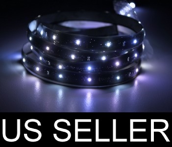

I didn’t mean ALL SMD LED’s are terrible, just those in particular. They are 0603 SMD LED’s. And based off the price and pictures, I assume they’re the BIN’s they cant use elsewhere. I have thousands of sample SMT LED’s laying around. The 0602s were about as dim as they get. Also, This image scares me…
http://img.auctiva.com/imgdata/1/3/6/9/8/0/3/webimg/388617228_tp.jpg
If the LED’s are that poorly binned in both luminosity and color, I would greatly question reliability. I assume the application isn’t very critical, however? The fact that they are running them in strings of 3 is also questionable… It is most likely due to them wanting to be able to use the terrible BIN LED’s that have high Vf’s, without worry of them lighting with a 12V drive.
PLCC-2 SMT LED’s can be quite bright, and being a SMD, they generally have no optics for wide angles. But a 0602 has a TINY die size… I would definitely pick standard T5’s over that…
