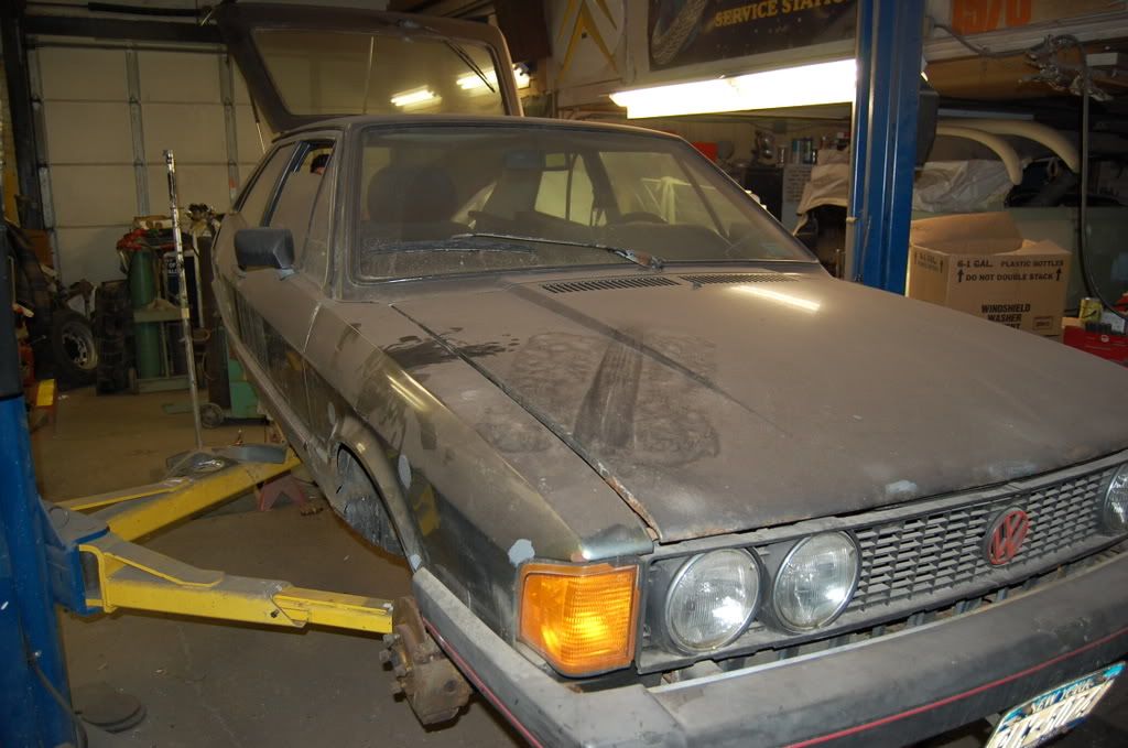

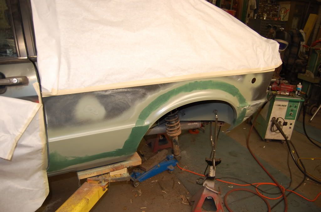

Snapped some pics today at work of what we are working on. First is a Scirocco that had a decent amount of rust. Here is what we have done so far:

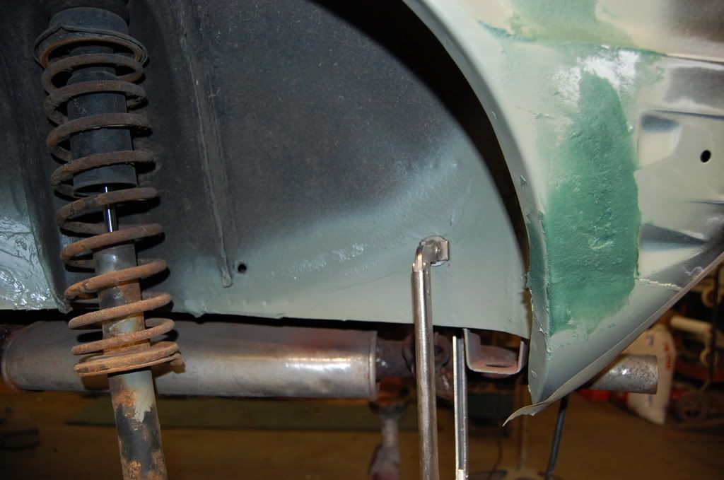

We had to replace the rocker on the driver side and also the inner wheelhouse which we finished last week.

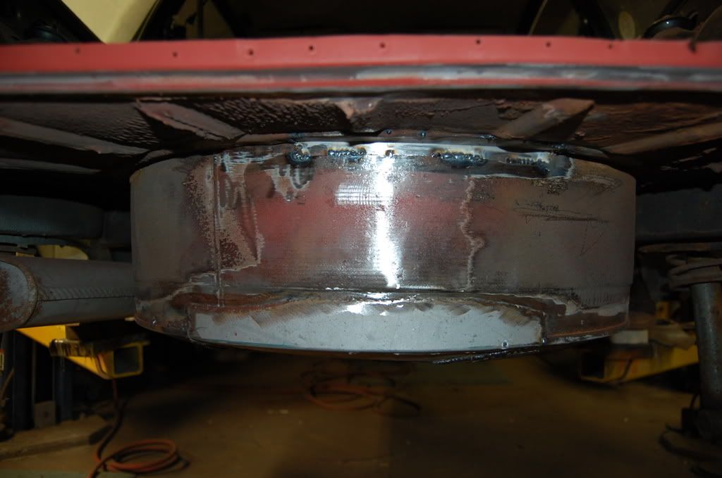

Spare tire well patch panels that we made:

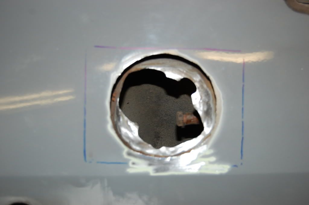

Gas filler patch that we need to finish:

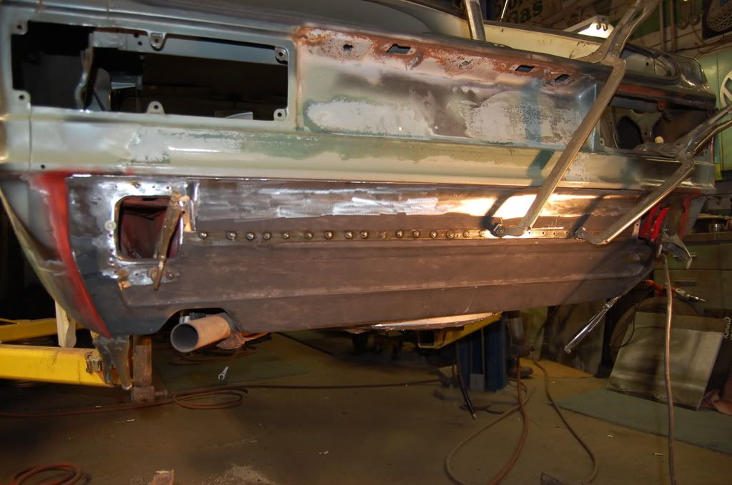

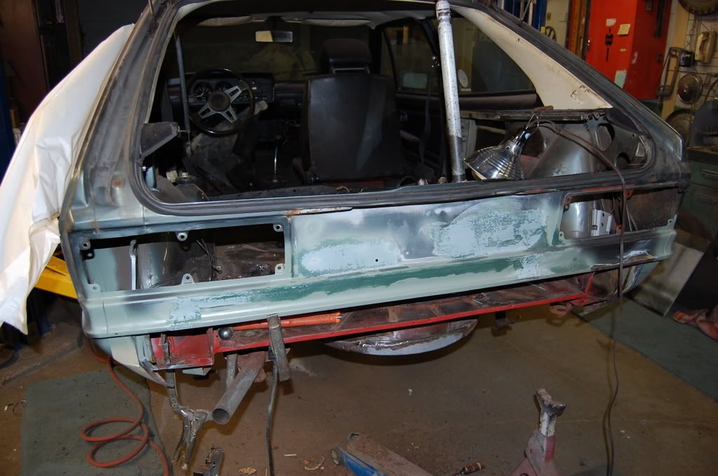

Here is what I did today, fitted the back panel and started welding it up:

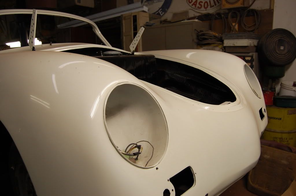

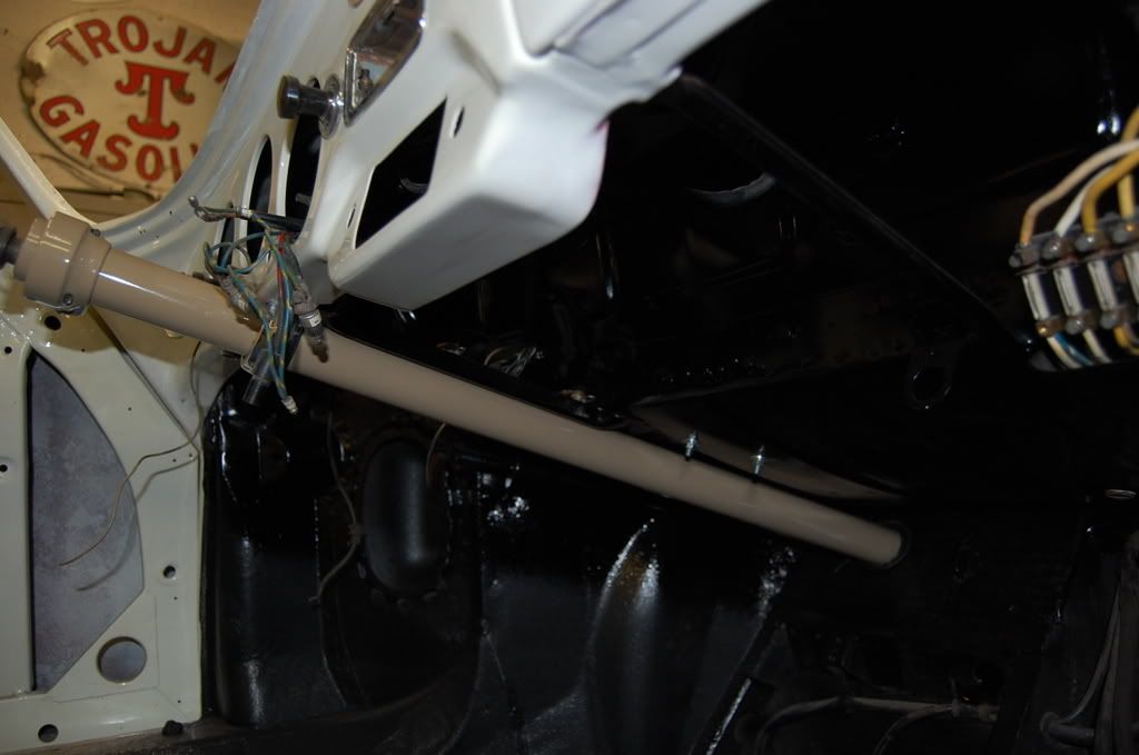

Ran the headlight wires and horn + turn signal wires:

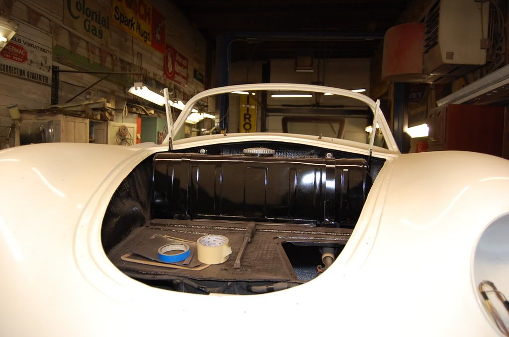

Gas tank painted and installed:

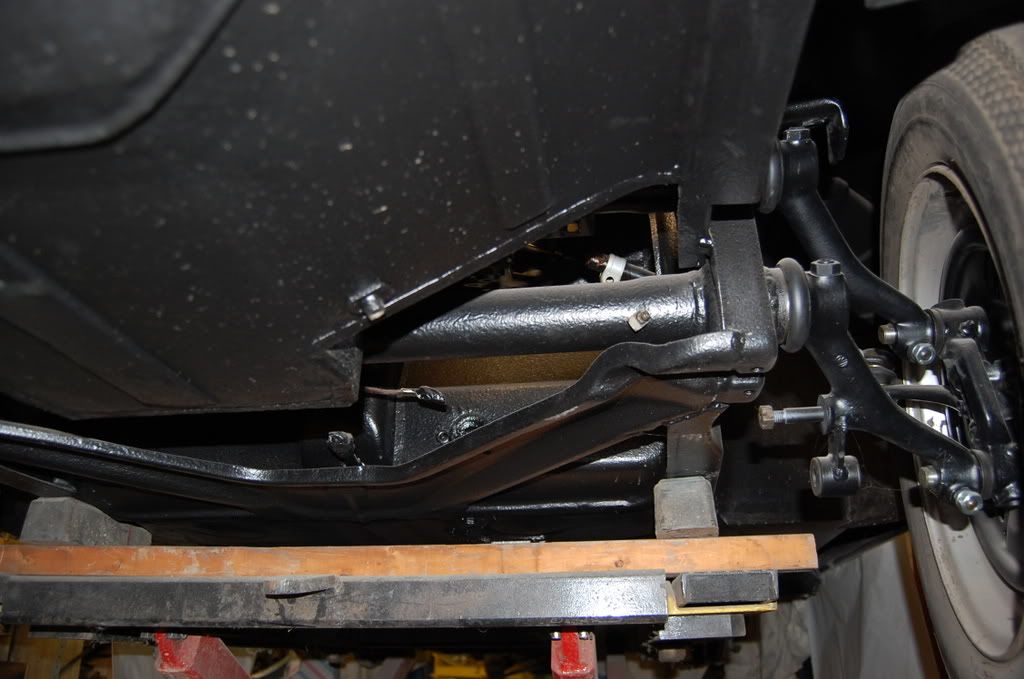

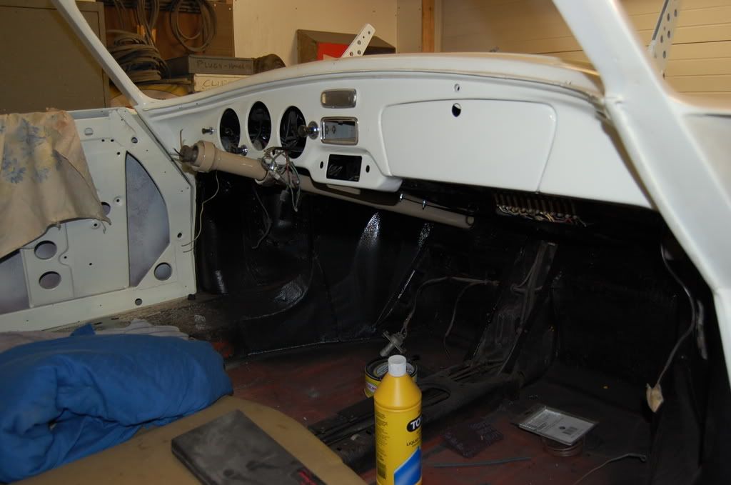

Underneath already done for the most part:

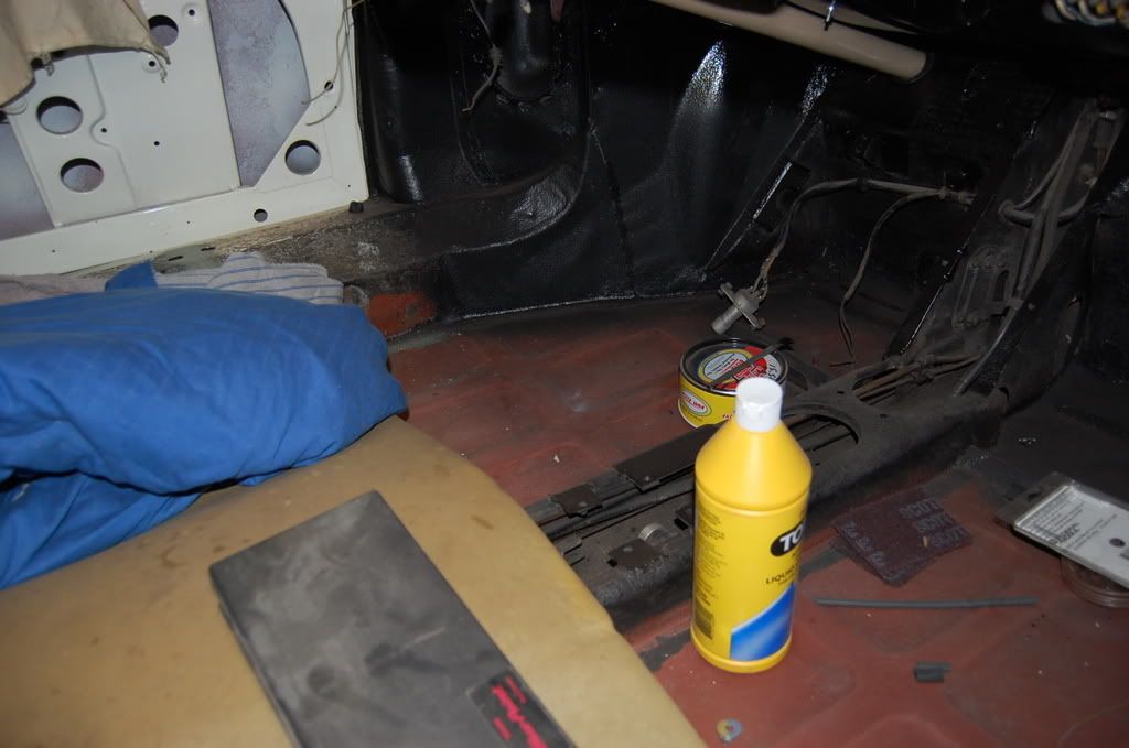

I had to repaint underneath the dash because the shop that painted the car originally over sprayed everything with white. I also had to scrape all the over spray off the wires, it was a huge PITA.
New floor:

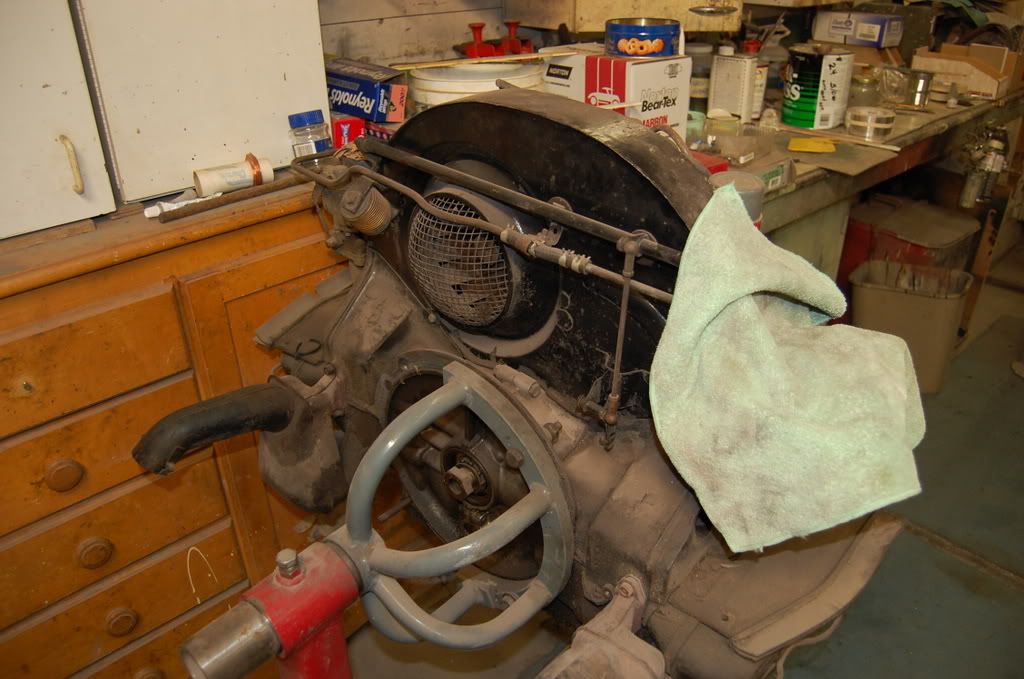

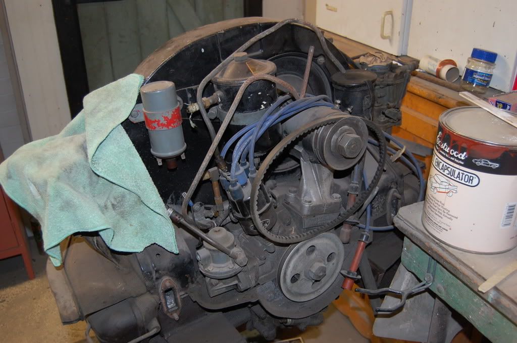

And finally the engine which we still have to take apart so we can repaint all the sheet metal and go through it:
