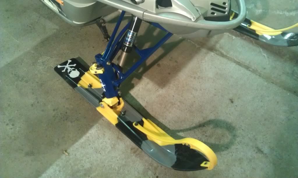

Project Fighter Cat now complete. Skis came in the other day and the bogeys I ordered came yesterday. Glad I decided to grease it Sunday and not wait. Two inner bogeys were going bad so I replaced all four of the center set. Skis mount without any sort of stiffener plate which I’m not thrilled about but they seem pretty rigid. Only time will tell. As expected when I give up plowing and have more time to ride, I’m walking around in a tee shirt. Let me know what you think of the results.

Looks good 1qikz, lovin it.
