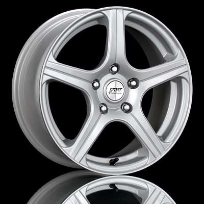

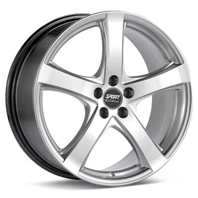

BTW, I need a set of those TD pro race wheels. WHat kinda wheels are u getting, Mike?
http://www.tirerack.com/images/wheels/sportedition/swap/se_e1_ci3_l.jpg
http://www.tirerack.com/servlet/CallJsp?target=wheelSearchCloseUp&wheelIndex=36&sizeIndex=1&showRear=no&setIndex=7&filterSize=&filterFinish=&filterSpecial=
http://www.tirerack.com/images/wheels/sportedition/swap/se_f6_ci3_l.jpg
http://www.tirerack.com/servlet/CallJsp?target=wheelSearchCloseUp&wheelIndex=40&sizeIndex=0&showRear=no&setIndex=8&filterSize=&filterFinish=&filterSpecial=
First pic is the 17x7", second pic is a 17x7.5" that I’m also considering, although I like the top one better. Both go for $99 a piece.
