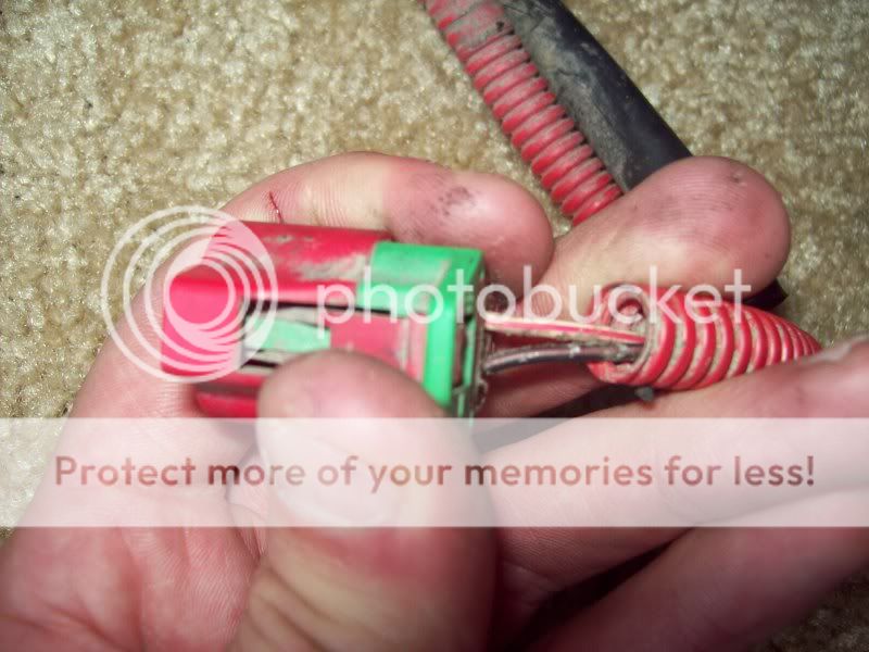

So randomly im looking under my dash today and i find 3 plugs which go to nothing. Can anyone identify them?? Sorry for the vid my camera no longer takes pics…
One is the neutral safety switch I believe.
The other one might be cruise control related. Do you have cruise still??
Do you have to depress the clutch to start the car??
Yeah i agree with Bobby.
i have cruise but aftermarket wheel, no i do not have to press clutch to start… one maybe to do with airbag?
The one is definitely the neutral safety switch then.
Airbag would be a good guess.
Ok thanx guys…

I am not positive, but I thought that the airbag had a bright red or yellow loom around it.
Brian’s article is all about connections in the engine bay. That is not going to help him with interior wiring.
As Bobby said the one is the NSS. I won’t be around my car for a week but I’m pretty sure the other one isn’t plugged in
It has a bright red wire loom

BTW, the other plug I couldn’t think of is the cruise cancel switch
