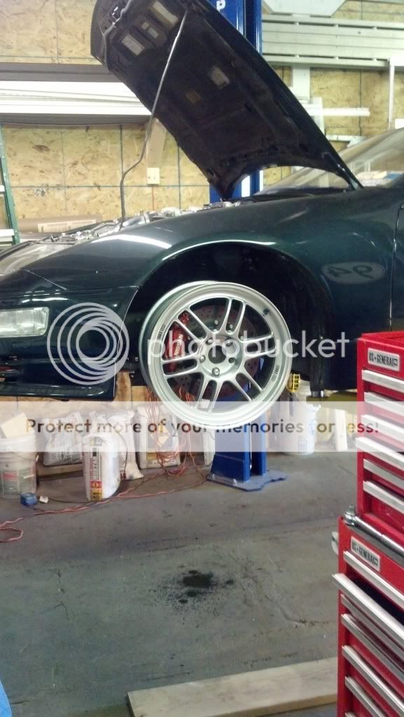

Thanks to 02NismospecV for dropping off some goodies yesterday. My Raijins came in but I missed the delivery so I decided to test fit the RPF1’s while my hands were dirty. I may go with the RPF1’s after all. Fitment seems good. Guess we’ll see.

Spoke design seemed more important than offset on my z…had the right offset but the large front caliper just touched due to an aggressively curved spoke to the hub.
I would say that it clears with the same spacing as my Volk’s. It’s close, but it makes it.

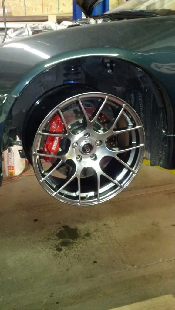

OK, this just got worse instead of better. I was able to catch the UPS guy and snag the wheels I ordered that I missed on Friday. Decided to sneak down to the shop to check fitment, clearances, etc. Low and behold, I friggin like these “track” wheels better than the Volks I have been running that came with the car and was trying to save from the track.
I had always said the wheels that came on this car were the shit and I’d never seen any other wheel I liked quite as much. I was wrong. Something about the silver grey tone of these just makes them look like they melt into the color of the car.

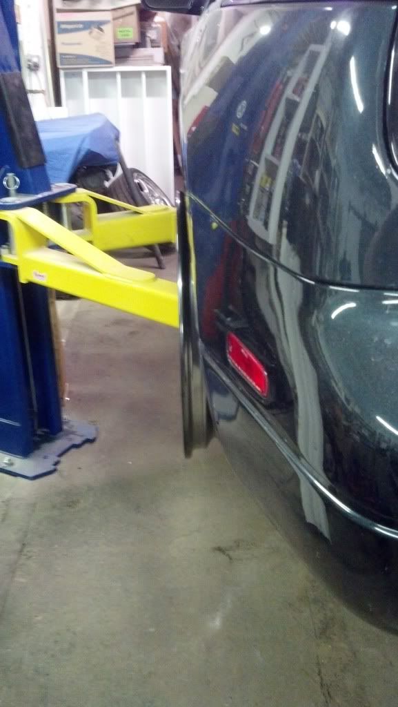

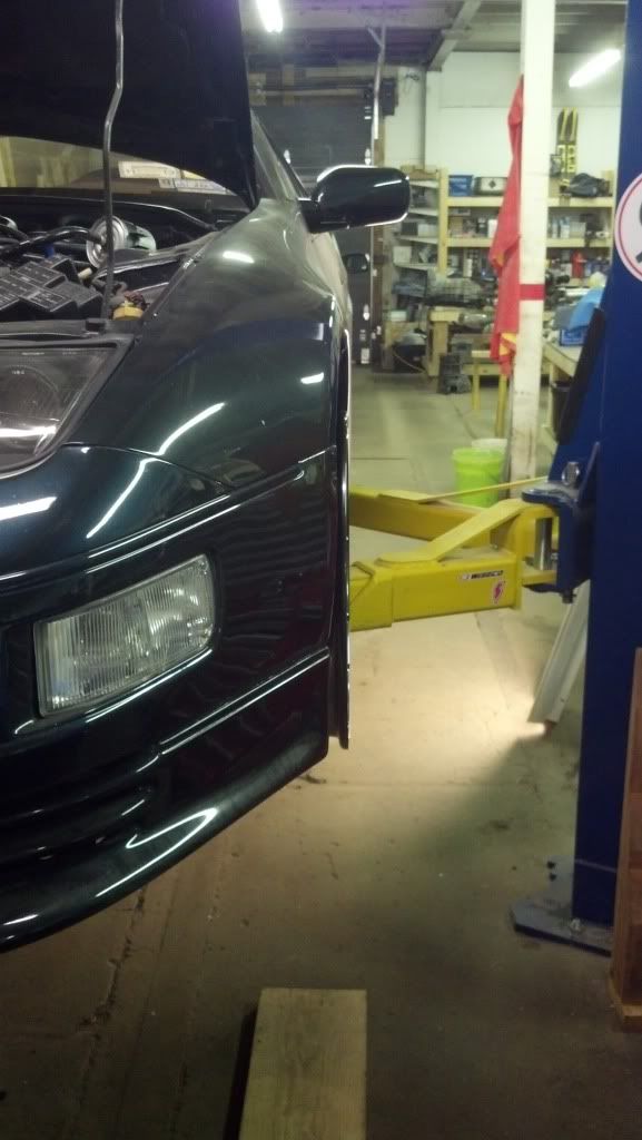

The new Enkei’s fit pretty well in the back. The fronts are another story. Since they are a 9.5" (up from a 9.0") they stick out quite a bit more. The rears aren’t quite so pronounced as I went down in width (10.0" to a 9.5") so they are almost the same as the Volk’s. The fronts clear the upper control arm and the brake calipers, but I’m not so sure about the fender. In my mind I was thinking a non-staggered track setup would be the most logical way to go. 9.5" seemed like a good compromise with the original 10’s and 9’s.
I might just send the whole set back and order another set of the Raijins in the same width and offset, since I know that already works. As much as I was against it, I may just end up running the Volks in their current setup with street rubber as that is what I was really going for in the first place, just with a little less cost risk involved. First world problems.
i don’t know what your volks look like, but i really like the new wheels
i can’t tell if you have the front wheel pushed up or not in that last picture, but the camber should fix that. you’re obv not going to be able to run a 285 or something up front lol. i would test it on the track first, or maybe you know already. but if you’re front end doesn’t push out too bad hard cornering i wouldn’t worry about a sq setup
it may even make you slower because of the extra tire. who knows
