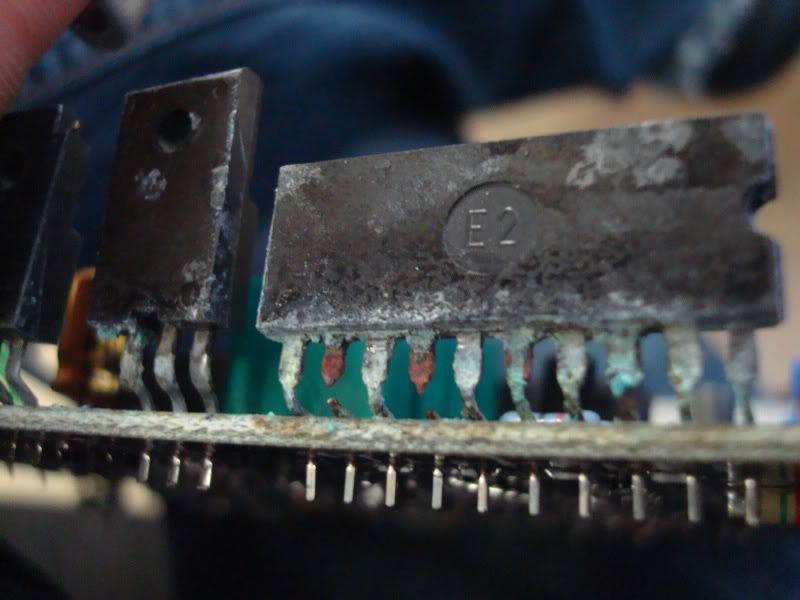

common to see green circuits inside the ecu.
also common to see broken wires/greenwires from ecu to injectors

I would take the cover off the ecu and check wiring.
^and or visually inspect the board for damage/corrosion…

the only true way to check is to use a oscilloscope… the easier way is to try another ecu.
I had a similar problem a while ago, sometimes acouple of the injectors would get stuck open, other times they wouldnt fire at all. Traced it back to the ECU, opened it up and found this
holy crap
Yea I replaced the ecu with two diffrent ecus and the probem was the same.

After more figuring some more things out it turns out my ecu was the same as sidewayz240 's. The reason it wouldn’t run on the other A/T ecu was because the 3rd and 4th plugs where soaked in fuel. So in the end, I suppose it was the ecu, just remember to air out that engine before starting the car with a new ecu. That being said I need a New ecu, who is selling a good m/t one?
